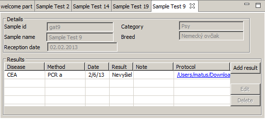

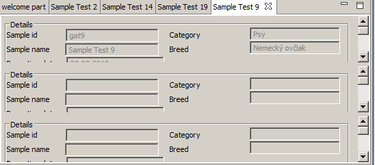

For some reason, the createContents method get executed multiple times, everytime the part is moved or has regaind focus, creating duplicate UI as can be seen in the picture below
Part after being created:

Part after switching to another part in the same stack and back - createContents has been called twice

Did I miss something obvious? Any advice would be most appreciated.
Thanks a lot
cheers
matus

Re: E4 RCP Part createContents gets executed multiple times [message #1006958 is a reply to message #1006853] Sun, 03 February 2013 03:36 Go to previous messageGo to next message
Better asked at e4-newsgroup, but anyways: You should not use @Inject
but @PostConstruct for the creation of the UI. @Inject methods will be
called everytime a value changes.
Tom

Re: E4 RCP Part createContents gets executed multiple times [message #1006978 is a reply to message #1006958] Sun, 03 February 2013 08:45 Go to previous messageGo to next message
Hi and thanks for the quick response.
The problem is, I had my methods annotated with @PostConstruct, but than they would not be executed at all. When I debug this I could see, that constructors got invoked, but not the createContents method. I actually managed to reproduce it with this sample:
Just add a Part to e4xmi manifest with the following code - the result is I can see the part, but it has not UI contents.
public class BasicNavigatorPart {
	private static final Logger log = Logger.getLogger(BasicNavigatorPart.class);
	public BasicNavigatorPart(){
		log.info("** Constructor "+BasicNavigatorPart.class.getSimpleName());
	@PostConstruct
	public void createControls(Composite parent) {
		log.info("** creating UI "+BasicNavigatorPart.class.getSimpleName());
The constructor is invoked, but not the @postConstruct annotated method.
Any pointers?
Re: E4 RCP Part createContents gets executed multiple times [message #1006979 is a reply to message #1006978] Sun, 03 February 2013 09:02 Go to previous message
OK I found the solution, seems to be related to this bug https://bugs.eclipse.org/bugs/show_bug.cgi?id=348123
Changing javax.annotation to 1.0.0 fixed the issues, and now the method with @postConstructs get invoked the way it should.
Thanks again for your help.
cheers
matus
