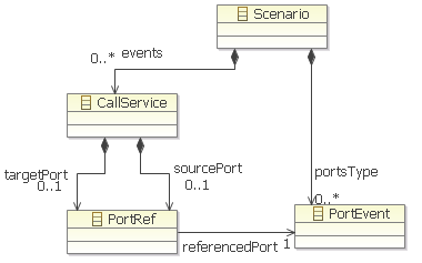

I'm dealing an scoping problem in my xtext language.
Let's see the grammar below and the associated MM (see attached)
CallService returns CallService:
	{CallService}
	'CallService' (=>'::'name=EString)?
	     ('sourcePort' sourcePort=PortRef)?
             ('targetPort' targetPort=PortRef)?
PortRef returns PortRef: {PortRef} referencedPort=[PortEvent];
PortEvent returns PortEvent:'PortEvent'{PortEvent} (=>'::'name=EString)?;
index.php/fa/13271/0/
I would like to provide scoping rules for targetPort and sourcePort in such that the targetPort's scope should not contained PortRef assigned to sourcePort ( and vis versa).
big question here is : how can i know where am i ?
To do it, i need to know where i'm : the Context. Precisly, i would like have the "PortRef" instance as Context's return in the function getScope(context, Ereference), but it's not the case.
I tried this function scope_PortRef_referencedPort(Ctx,ref) in scope, but the Context passed in my function is an instance of CallService and not of PortRef like it supposed to be.
And that despite of the fact that i put {PortRef} intructions to force that the object creation.
Am i missing something ?
i hope i was clear.
Best regards.
F.

Yes Ian, i can do context.getSourcePort() or context.getTargetPort.
my question is exactly for which of both EReference ( sourcePort or targetPort) i'am scoping ?
Because i can not just do (context.getSourcePort() != null ) or (context.getTargetPort !=null) to know which one of both EReference user hint Crtl+Space. That will not cover users udaptes.

Re,
I'm hoping the ref parameter is a ReferencedPort so perhaps its getName() will be either "sourcePort" or "targetPort".
ref parameter is an EReference. Its getName() is "referencedPort" and its eContainer() return an EClass ( not an EObject).
F.
Re: Ambiguities in xText scoping "Context" [message #1067567 is a reply to message #1007069] Tue, 09 July 2013 07:30 Go to previous message
Revisting this after seeing it in another post, as I've been moving my work to xtext 2.4 and had to rework the scoping.
It looks like the extra layer of PortRef doesn't help. If you simplify to this:
CallService:
        {CallService}
	'CallService' ('::' name=EString)?
	     ('sourcePort' sourcePort=[PortEvent])?
             ('targetPort' targetPort=[PortEvent])?
PortEvent: {PortEvent} 'PortEvent' ('::' name=EString)?;
Then in your scope provider (or delegate) scoping method check if reference == YourDSLPackage$Literals::CALL_SERVICE__SOURCE_PORT or CALL_SERVICE__TARGET_PORT to see which one you are in. You won't care what the context is.
(if you're pre-2.4 with a Java scoping class then its '.' instead of $ or ::)
