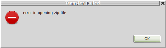

I am experiencing a recent problem trying to download Eclipselink in the JPA Facet configuration form in Eclipse. I have selected the EclipseLink 2.4.x and then select the download button. I am then presented a list of the eclipselink download options from 1.1.4 all the way through the current 2.4.1 - Juno release. It then populates the Library Name and Download destination fields. I then select next to accept the terms and conditions and then select the finish button. The download begins and then almost immediately the Transfer Failed dialog appears with the error in opening zip file. This process worked a couple of weeks ago with out any issues. But a couple of days ago I was helping a fellow developer configure their new computer and this is when I noticed the error. I have since tried it on environments that were working (Mac OS X), Windows and Linux to no avail. I also tried even using a 2.3.x version with the same results.

Re: EclipseLink Download Error [message #1008235 is a reply to message #1006729] Mon, 11 February 2013 11:31 Go to previous messageGo to next message
Tried this for the first time today, and it failed for me too.
I run Eclipse 4.2 (Juno) on Linux Mint 14.
Any workaround will be much appreciated, as I am writing course material on
Google Cloud SQL.
- Jan
index.php/fa/13371/0/

The issue has been identified and we are working on a solution. The issue can be tracked here: https://bugs.eclipse.org/bugs/show_bug.cgi?id=400611.

This issue should now be resolved.
