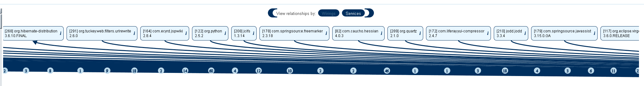

I attached an example of a part of a real WAB diagram with 168 dependency bundles (wiring1.gif). As you can see, it is absolutely illegible. But, if you will move a circle with the imports quantity under a bundle rectangle it will be more readable.

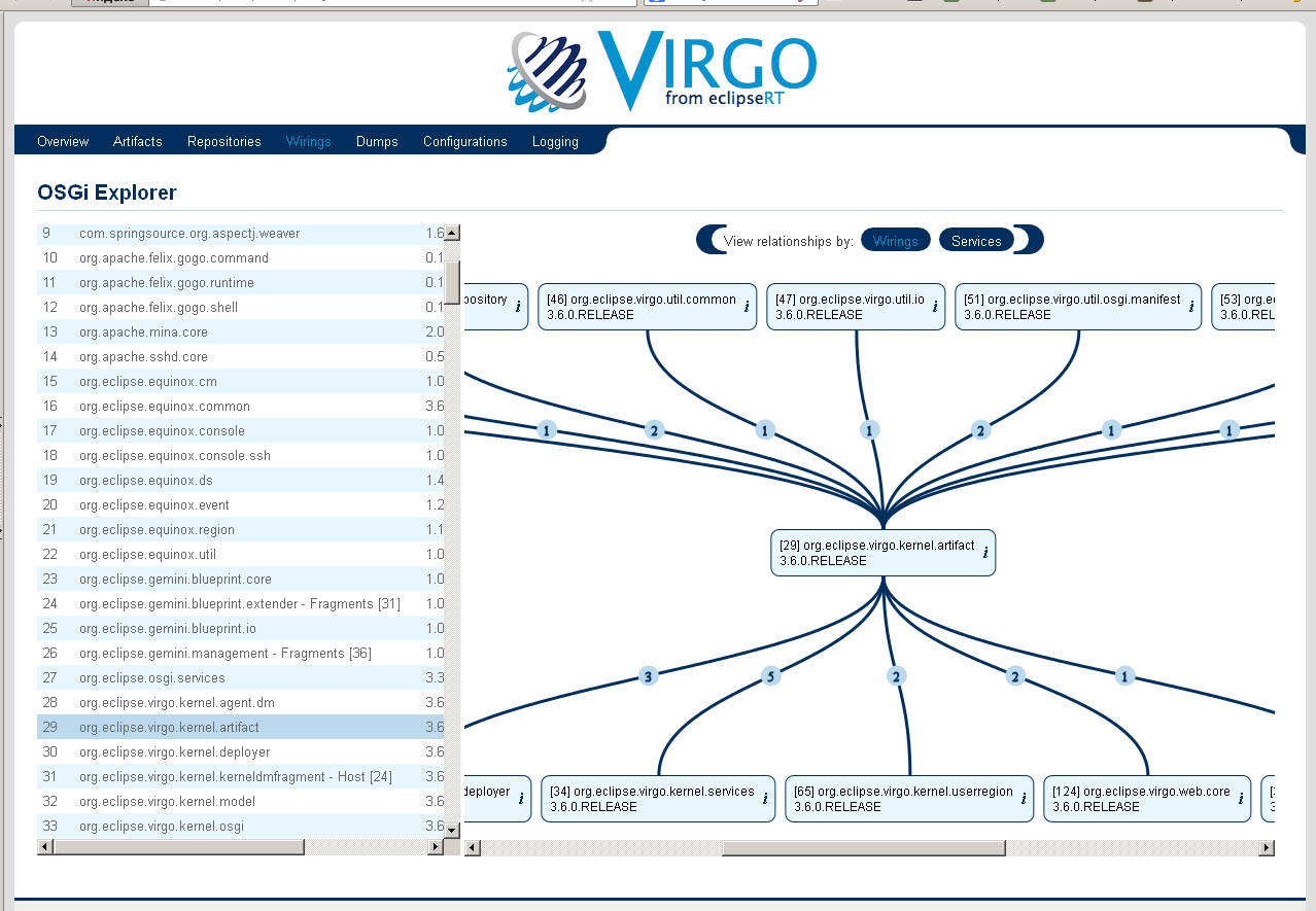

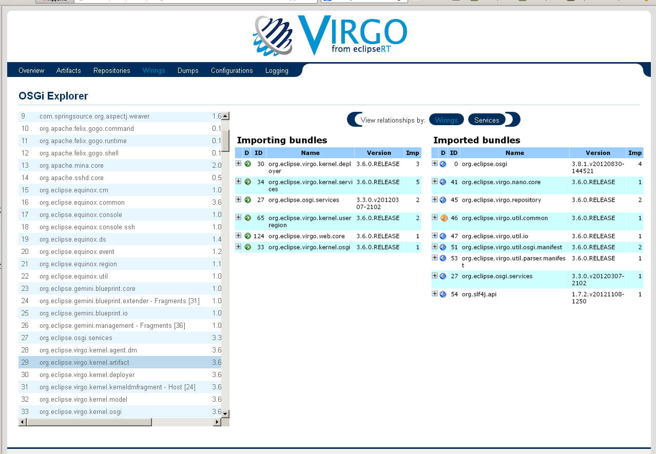

It contains identical capacity of sensitive information, but is more compact and readable and expandable vertically. Furthermore, it deliver from the popup windows of the importing description and will be rendered faster.
On the other hand, If you will improve the render and it will visualize in the browser window a whole (or almost) graph with several levels of dependencies onto the full screen and with the radial\hierarchical nodes arrangement it will be perfect and very useful! But.. it seems to me there is not a need to overload the admin application by advanced development features. This is a purpose of Virgo Tools.

Thanks for raising this. We certainly want complex wiring diagrams to be usable. We considered adding an "escalator" feature for this (if an escalator stops moving, at least you can use it as stairs) but didn't have enough time. Please raise an enhancement request so we have this requirement captured.
