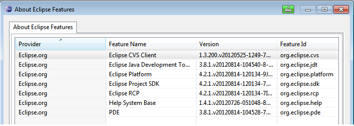

I installed eclipse juno (see attached img) and created a simple Application.e4xmi file and worked on it with the model editor. When I run the product, it works fine so far, but it gives me the "deprecated"- messages below and I'm wondering if I missed something with the installation ?

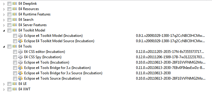

Re: CSS property 'unselected-tabs-color' has been deprecated [message #1006463 is a reply to message #1006451] Thu, 31 January 2013 07:01 Go to previous messageGo to next message
Yes, see attached img for details.
Re: CSS property 'unselected-tabs-color' has been deprecated [message #1006469 is a reply to message #1006463] Thu, 31 January 2013 07:21 Go to previous messageGo to next message
Those are really old they are from 2011! What updatesite url are you using?
