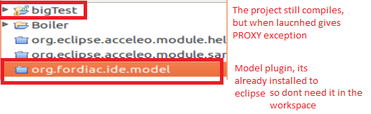

Hey again!!
I just noticed that, if the model project is also open as a project in the workspace, then acceleo plugin application launch works perfectly. But if i close the project, everything still compiles, but the acceleo plugin application launch gives me the proxy error [notice please that its not even JAVA launch]. The model plugin is already installed to Eclipse. Seems that Acceleo doesnt see it when launching the app, but it saw it perfectly when i was creating the project.. Why?
Attaching the screenshot as well

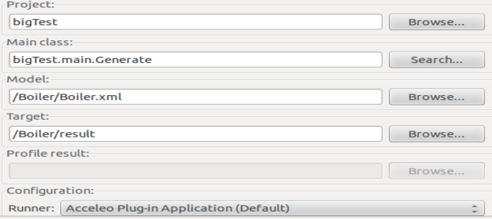

thanx for collaboration. Sorry, I though there might be some general approach for my case. Attaching now some sources and output.
Concerning URIs being used to load the instances, i just set it in the Acceleo launch configuration window. See the screenshot please.
This is what i get for eProxyPath while debuggin:
file:/home/veronika/Program_Files/CLEAN/4DIAC-IDE_1.2.0_Linux/workspace/bigTest/bin/bigTest/main/org.fordiac.ide.model#//AutomationSystem)

hey!
trying to debug, it turns to be really complicated :l
For sure there is no such file path .. seems like it is concatted from the path to mtl file + uri of the object in the meta-model..
Seems like for some reason it looks for the meta-model object reference in the mtl file folder instead of using installed eclipse plugin..
Finally should be smth like this I guess:
platform:/plugin/org.fordiac.ide.model/model/fordiac.genmodel#//AutomationSystem
Could i register somehow this particular path for the 'org.fordiac.ide.model' uri?
Thanx in advance!

And once again, can we go back to the initial problem instead of going to the standaloneprojectmap and whatnot?
> It works perfectly when i launch it from eclipse as Acceleo plugin.
This is expected, since in such a case you benefit from the registrations made by EMF and other plugins.
> the first parameter of the main template is a proxy
As Ed Merks mentionned, this is due to the resolution of some references failing. However, contrarily to what he mentions afterwards, this _is_ more often that not due to a failure in resolving a metamodel (a missing or incorrect package registration). Acceleo modules are models themselves; their own metamodel is resolved (since it is Acceleo itself). However, the "target" metamodel of your transformation is the culprit. In this case, you "target" a metamodel which NsURI should be org.fordiac.ide.model because of your module's signature : [module generate('org.fordiac.ide.model')].
Is that the actual NsURI of your model? If yes, it should also be what's returned by a call to LibraryElementPackage.eNS_URI. Otherwise, your registering of resourceSet.getPackageRegistry().put(LibraryElementPackage.eNS_URI, LibraryElementPackage.eINSTANCE); is incorrect.
You also seem to have the project containing your metamodel both as a project in your workspace and as an installed arteface in your current Eclipse. This is rarely a good idea. You might want to close/remove the project, restart your eclipse, then try re-compiling your acceleo modules. That should make for better serialized URLs from EMF.
