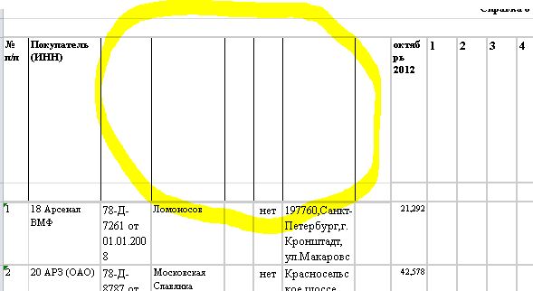

Hello!
I have a long text for a column title and 30pixels for width colomn for it
can I turn text or label for 90 grad,how?
and can I change place of right row agregation colomn in cross tab before date to make it a first colomn, how?
thank you
Elena

Re: How to turn text in label or label for 90grad ? [message #1016621 is a reply to message #1006028] Thu, 07 March 2013 02:51 Go to previous messageGo to next message
Thank you very much!
it is work good in html format (this RotatedText),
but there are no in xls format
what can we do to show them in xls format?
Elena
index.php/fa/13726/0/
  • Attachment: null cell.JPG
    (Size: 37.16KB, Downloaded 2700 times)

Re: How to turn text in label or label for 90grad ? [message #1016886 is a reply to message #1016786] Thu, 07 March 2013 23:53 Go to previous messageGo to next message
The rotated text item creates an image, I believe. The standard XLS emitter does not support images. This is probably why it doesn't work for you in XLS. If you try another XLS emitter, like this one: BIRT Exchange Marketplace - Spud Soft BIRT Excel Emitters, it might work for you, cause there is image support. You might give it a try. As far as the other outputs, it should at least work in pdf, but I don't see why the others wouldn't work, as well. The code for creating the rotated text element can be found in the BIRT source code. For 4.2.2, you might have to go get the source and build the plugin project yourself.
