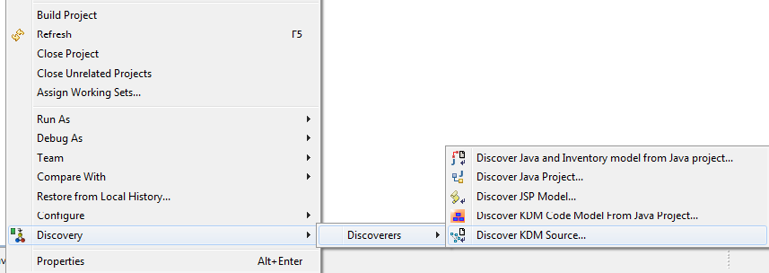

Hello. thanks again for the answers.
I'm working with the MoDisco distribution available with Eclipse Indigo. I attached a file showing all the discoverers that i found there. when i parse my kdm code model, i'm able to get some ActionElement of my java project. Nevertheless, when i invoke the "getOutBound" method on each of these ActionElement in order to get all their outgoing KDMRelationships, i always get a "null" value, whereas the MoDisco Model Browser indicates that my code model contains Calls going from the ActionElement contained in my project. So, i would like to know, if i'm not using the right method to get these outgoing KDMRelationships or if i there is an alternative to get them.

Re: How to process my KDM models [message #1006669 is a reply to message #1006598] Fri, 01 February 2013 06:27 Go to previous messageGo to next message
Looking to a KDM model opened into the MoDisco Model Browser, on an ActionElement the relationship to access to the Calls elements is named actionElement.
You could try to use this relation to get the Calls model elements.
Hugo
