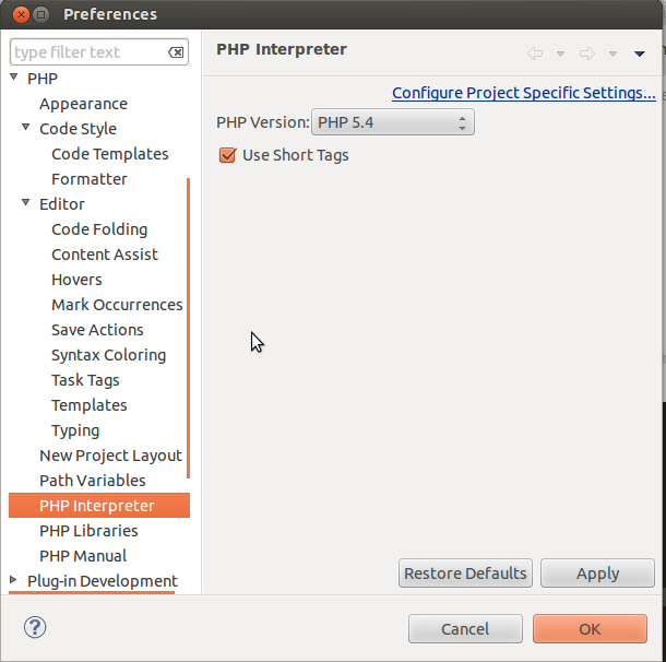

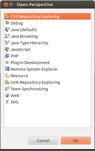

If i go to "Window"->"Preferences" then uncollapse the PHP section I do not see a Debug section. Also, if i go look at my available perspectives I do not see PHP Debug.

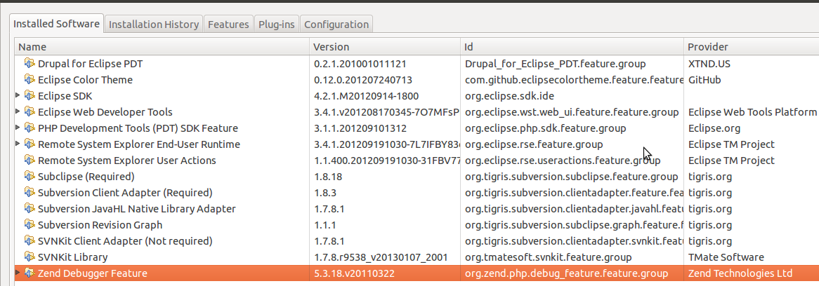

I attached images showing my installed software, my list of available perspectives, and the PHP section of the list of Preferences.

'PHP Debug' perspective had been removed on PDT 3.0. PDT uses 'Debug' perspective now. So it is not a problem.

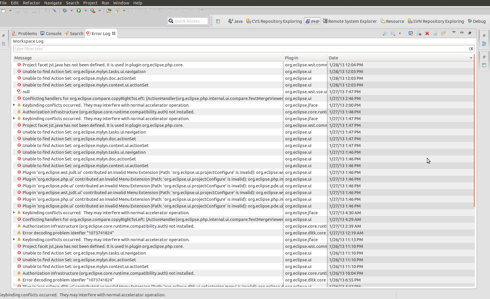

I just checked the error log via eclipse and I have attached a screenshot of all the errors over the last couple days. I did a restart today around noon so i assume any startup errors would be included. Doesn't seem like anything related to php debug.
