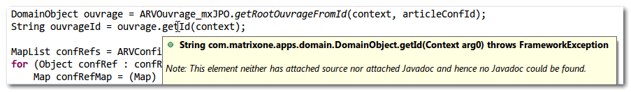

Hi. I'm working on some big Java enterpriseware (MatrixOne / ENOVIA V6, if you mind). The maintainers provide some kind of Javadoc, and I am able to read it as HTML in my browser.
However, I'm currently not able to integrate it to Eclipse, which is painful, because instead of just reading the Eclipse doc popups, I have to make round-trips to my browser. Here is what it looks like in Eclipse:
index.php/fa/13074/0/
After learning that the Javadoc can be defined at project and .jar level, I tried to do that, knowing that:
  1. the javadoc folder contains a packages-list file (see attachment), which seems to sanely define the documented packages
  2. the javadoc folder contains the typical folder/subfolder package structure, itself containing ClassName.html files. E.g. the com.matrixone.apps.domain line of my packages-list file is matched by a com/matrixone/apps/domain, containing lots of ClassName.html files
  3. the javadoc folder doesn't contain a index.html file
When I try to define my Javadoc, the Validate... button fails, because of the missing index.html. Then if I create a dummy index.html file, validation works, but I still cannot see the Javadoc when hovering a vendor class/method.
So my basic question is: How can I get this skewed Javadoc to display in Eclipse? Sub-questions I see at this point are:
  1. Was it a bad idea to create a dummy index.html file? If yes, what should I do? (i.e. what tags/meta-information does Eclipse expect?)
  2. A quick comparison of a standard Javadoc file (String.html, see attachment) vs. one of those vendor Javadoc (DomainObject.html, see attachment) reveals that meta-information possibly used by Eclipse is absent from my javadoc. For example, my Javadoc includes none of the many <meta> tags present in the String.html Javadoc
    → Does somebody know the logic/heuristic used by Eclipse to fetch a method/class Javadoc? Maybe point me to the code? With this information I may be able to understand what's skewed in my Javadoc, and hopefully fix it.
  3. Anything you see fit if you ever faced a similar problem Smile
I'm currently using Eclipse Juno SR1 on Java 7, under Windows 7.
Of course, feel free to ask for information I forgot to include. Thanks for your help!

This should work assuming that
- the Javadoc location points to the root where the package structure
(e.g. 'com') starts
- the file names in the leaf folders follow this pattern <typeName>.html
Dani

Re: Need help to integrate a vendor's Javadoc to Eclipse [message #1006226 is a reply to message #1006194] Wed, 30 January 2013 08:58 Go to previous messageGo to next message
Hi Dani,
Yes, both constraints are respected:
  1. the Javadoc location points to the root where the package structure (e.g. 'com') starts
  2. the file names in the leaf folders follow this pattern <typeName>.html
I'm attaching a listing of the Javadoc root, generated with dirhtml.

I can't tell why it's not working. You would have to create an example
and file a bug against JDT UI.
Dani
