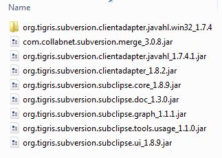

I downloaded the latest version of EPF and on running it, found that the SVN Repository is missing.
As a workaround (which seems to be working so far), I moved all the plugin files which contained "subversion" in their name from EPF 1.5.1.4 Plugins folder to the EPF 1.5.1.5 Plugins folder.
So far, so good.
Are their any issues that anyone foresees doing things this way? Has anyone encountered any issues so far?
The files copied over were are attached in the image
  • Attachment: Capture.JPG
    (Size: 30.25KB, Downloaded 461 times)

I'm trying to install SVN on my 1.5.1.5 EPF too. As far as I could understand you got the plugin from 1.5.1.4 and installed it over 1.5.1.5.
After I read your thread I tried to do the same but when I downloaded the 1.5.1.4 to get the files you listed on the image, there were none. Also there was no option on the menu to install plugins. Are you sure you got them from 1.5.1.4? If so, how did you manage to install them there in the first place?

It turns out that the 1.5.1.4 version that I had installed earlier (had taken the setup rom someone else), already had the SVN plugin files in it. So the setup you downloaded from IBM would not contain them.
I will post a step by step guide later tonight so you can install them. Watch this space.
