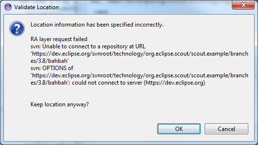

I've been able to view the BahBah source code using a web browser but have failed to do a checkout from that URL either using TortoiseSVN or Eclipse.
Tortoise says: "Could not connect to server https://dev.eclipse.org". I've tried using svn:// and http:// but that didn't help.
Eclipse fails when I try to add the SNV location saying with the error message below:
index.php/fa/13138/0/
I've tried to merge the SWT based code into my code and while it compiles, it also fails to show a toolbar.
Could this be related to the bug where the dynamic menus disappear when the outline is set (because I am seeing this bug in my application, so maybe the SWT toolbar disappears for the same reason)?
If I set breakpoints in ApplicationActionBarAdvisor I can step through

  • Attachment: svnerror.png
    (Size: 45.12KB, Downloaded 1568 times)
Re: How to switch outlines with SWT [message #1006129 is a reply to message #1005921] Wed, 30 January 2013 01:34 Go to previous messageGo to next message
I could run:
svn checkout http://dev.eclipse.org/svnroot/technology/org.eclipse.scout/scout.example/branches/3.8/bahbah
Are you sure you are not behind a proxy or something like that ?
Re: How to switch outlines with SWT [message #1006135 is a reply to message #1006129] Wed, 30 January 2013 02:17 Go to previous messageGo to next message
Jeremie
I am sure that I *am* behind a proxy. However, for TortoiseSVN I have setup the proxy config a long time ago (and succesfully retrieved sources from other external svn servers in the past) and in eclipse I was expecting the general proxy settings to be used (which are regularly succesfully used when installing and updating software).
After your post, I checked the TortoiseSVN settings and it seems that the proxy port has changed since I set it up in there, so after fixing the port number I was able to retrieve the code using tortoise.
For Eclipse I have not found any setting to specify a separate proxy for SVN access and still don't know why it can't connect through the proxy server that is defined for eclipse. Anyway, I've got the code, so I'll start building the project to see if the BahBah application shows the toolbar.
Thanks for your reminder to check the proxy settings.
