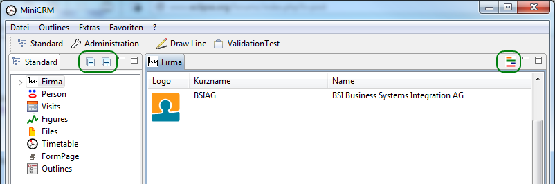

Re: Expanding the outline tree [message #1018279 is a reply to message #1018163] Wed, 13 March 2013 10:51 Go to previous messageGo to next message
Here I am again.
I have succesfully managed to add dynamic toolbars to my views. I proceeded as follows:

Then, for each view intended to have a toolbar, I created small classes extending this abstract class:
package org.eclipse.minicrm.ui.swt.toolbars;
public class ViewToolBarOutline extends ViewToolBar {
  protected String getView() {
    return "OutlineView";
and
public class ViewToolBarTable extends ViewToolBar {
    return "TableView";
These classes are used so we can have different toolbar buttons for each view. By returning a different view-name, we can then request the corresponding buttons from the ClientSession using getViewButtons().
This method is of course still missing. The DesktopMenuBar (and potentially ApplicationActionBarAdvisor) get access to menus, view buttons and tool buttons defined in the client's Desktop class directly through getMenus(), getViewButtons() and getToolButtons(). Unless we want to duplicate those buttons on our views, we cannot use these three methods (nor the comfortable mechanism of just adding classes of the correct type to Desktop) for our purpose.
Instead, I added a container to the ClientSession, which is filled by the Desktop on startup and which can be queried by the ViewToolBar class when creating the toolbars.
Add the following member and methods to ClientSession:
  private Map<String, List<IAction>> viewButtons = new HashMap<String, List<IAction>>();
  public void addViewButton(String view, IAction buttonAction) {
    if (view != null && buttonAction != null) {
      List<IAction> actions = viewButtons.get(view);
      if (actions == null) {
        actions = new ArrayList<IAction>();
      if (actions != null) {
        actions.add(buttonAction);
        viewButtons.put(view, actions);
  public IAction[] getViewButtons(String view) {
    List<IAction> result = null;
    if (view != null) {
      result = viewButtons.get(view);
      if (result != null) {
        return result.toArray(new IAction[result.size()]);
    return null;
Now all that remains is to create the actions to be used on the view-toolbars in Desktop:
  public class OutlineTreeExpandCommand extends AbstractAction {
    public String getIconId() {
      return Icons.Expand;
    protected String getConfiguredTooltipText() {
      return TEXTS.get("Expand");
    protected void execAction() throws ProcessingException {
      if (extendedTreeForm != null) {
        extendedTreeForm.setTreeNodeState(true);
  public class OutlineTreeCollapseCommand extends AbstractAction {
      return Icons.Collapse;
      return TEXTS.get("Collapse");
        extendedTreeForm.setTreeNodeState(false);
  public class TableActionCommand extends AbstractAction {
      return Icons.Action;
      return TEXTS.get("TableAction");
      system.out.println("TableAction");
As a last step, we need to instantiate and register our commands when the Desktop is being started:
  protected void initConfig() {
    super.initConfig();
    ClientSession session = ClientSession.get();
    if (session != null) {
      session.addViewButton("TableView", new TableActionCommand());
      session.addViewButton("OutlineView", new OutlineTreeCollapseCommand());
      session.addViewButton("OutlineView", new OutlineTreeExpandCommand());
And the result looks like this:
index.php/fa/13832/0/

Re: Expanding the outline tree [message #1020541 is a reply to message #1018279] Mon, 18 March 2013 08:18 Go to previous message
In this post I had been wondering how to store/restore windows positions/sizes as well as View configurations with SWT. I was told to add
configurer.setSaveAndRestore(true);
to ApplicationWorkbenchAdvisor.initialize().
While this worked, it has the drawback that the global Coolbar is not restored correctly (it only shows the first button).
The implementation of the View toolbars described above has a similar problem, if SaveAndRestore is set to true, the view specific toolbars are no longer shown on startup. Minimizing and restoring a view, or switching between views sharing the same region forces the toolbar to be shown again.
Analysing the problem a bit further, I found the reason for this: Without storing the window position/size (in workbench.xml) the fill() method of our toolbar are only called after the client and SwtEnvironment have been initialised. If we are storing the window position/size, these methods are called much earlier (when the XML file is read), at which point we cannot yet access the client/SwtEnvironment to create the buttons.
To allow for this, we must store the parent and index with which our fill() methods were called, so we can call them again when the client is ready to provide this information. We also need to tell each view to force an update of the toolbar.
This requires the following code changes:
ViewToolBar needs two new members:
  private ToolBar m_parent = null;
  private int m_index = 0;
which are set when the fill() method is called:
  public void fill(ToolBar parent, int index) {
    m_parent = parent;
    m_index = index;
    // ... rest of method as above
Then, we must register the toolbar with the SwtEnvironment, so it can tell the toolbar to configure itself once the necessary information is availbale:
  public ViewToolBar() {
    super();
    ((SwtEnvironment) Activator.getDefault().getEnvironment()).addViewToolBar(this);
  public ViewToolBar(String id) {
    super(id);
  public void refreshToolBar() {
    if (m_parent != null) {
      fill(m_parent, m_index);
SwtEnvironment must be extended to allow for this:
  private Set<ViewToolBar> m_viewToolBars = new HashSet<ViewToolBar>();
  private Set<IRefreshableToolbarView> m_views = new HashSet<IRefreshableToolbarView>();
  public void addViewToolBar(ViewToolBar viewToolBar) {
    m_viewToolBars.add(viewToolBar);
  public void addView(IRefreshableToolbarView view) {
    m_views.add(view);
Now, the listener for SwtEnvironmentEvent.STARTED must be extended. Change
  m_advisor.initViewButtons(d);
to
  Iterator<ViewToolBar> itb = m_viewToolBars.iterator();
  while (itb.hasNext()) {
    itb.next().refreshToolBar();
  Iterator<IRefreshableToolbarView> itv = m_views.iterator();
  while (itv.hasNext()) {
    itv.next().refreshToolbar();
Finally, all our views must register themselves with the Environment as well. Define a new interface:
public interface IRefreshableToolbarView {
  public void refreshToolbar();
and make sure every view implements it and adds the following methods (shown for TableView, needed for all views that have a toolbar).
public class TableView extends ValidationAbstractScoutView implements IRefreshableToolbarView {
  public TableView() {
    ((SwtEnvironment) Activator.getDefault().getEnvironment()).addView(this);
  protected ISwtEnvironment getSwtEnvironment() {
    return Activator.getDefault().getEnvironment();
  public void refreshToolbar() {
    getViewSite().getActionBars().getToolBarManager().update(true);
This ensures that the view specific toolbars are correctly redrawn even when setting SaveAndRestore to true.
