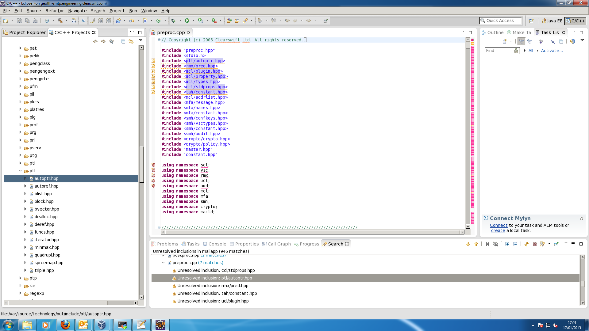

The Java version is fine, but the C++ version gives unresolved inclusions
Probably as a result of the unresolved inclusions, there are a large number of errors

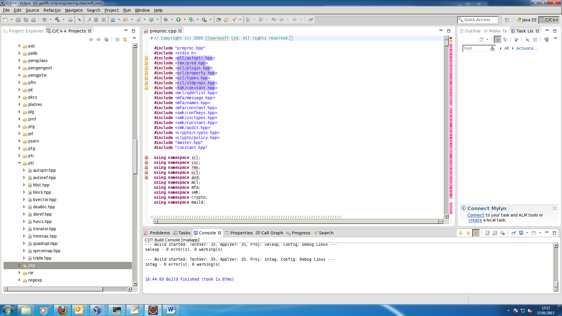

However, I can build the project with no errors

I've attached 2 image files (hopefully they will be included in line):
The image file UnresInclusions.png shows the following:
class preproc.cpp with a number of unresolved inclusions and a large number of errors
- in particular include file <ptl/autoptr.hpp> is unresolved
- BUT in the left hand window, it can be seen as on the include path
index.php/fa/13004/0/
The image file BuildProcess.png shows the successful build
index.php/fa/13005/0/
I've done various things to try and resolve including:
re-index
restart Eclipse
restart VirtualBox
- nothing has resolved the problem
Thanks for reading and any help much appreciated
