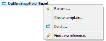

First, part of my confusion was, that apparently the SnapBox is not fully supported by the SDK, as you cannot add buttons to it through the SDK.
index.php/fa/13030/0/
