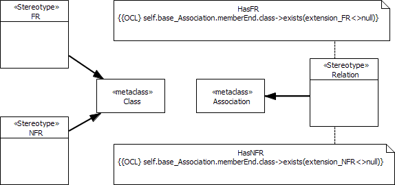

Hi<br>
<br>
The following should be possible in Kepler M5. It was created using
the latest Papyrus development code using the EssentialOCL editor
integration. The OCL text has therefore been semantically checked
(at M2). Actual functionality at M1 is still work in progress.<br>
<br>
<img src="http://www.eclipse.org/forums/index.php?t=getfile&amp;id=13164" alt=""><br>
<br>
No need to lose type safety with getAppliedStereotypes.<br>
<br>
    Regards<br>
<br>
        Ed Willink<br>
<br>

  • Attachment: bhhgdhjd.png
    (Size: 8.70KB, Downloaded 382 times)

I also have a similar metamodel and want to specify the member ends for an association metaclass. I am using Papyrus to create my profile. I have used these two constraints:
1- self.base_association.memberEnd->exists(getStereotypeApplication(FR) <> null)
in this case, it gives an error for getSetreotypeApplication as an unresolved operation.
2- I also tried the one in the attached file:
self.base_Association.memberEnd.class->exists(extionsion_NFR <> null)
this one does not check when if one of the member ends is not NFR.
