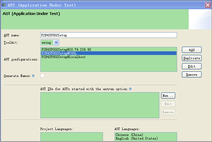

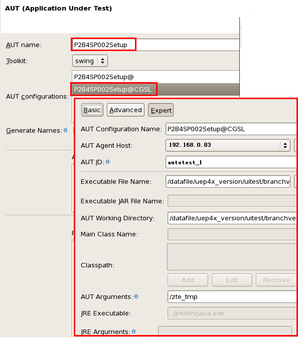

Re: testexec from Windows connect to linux AUT failed at the end [message #1003346 is a reply to message #1002208] Sun, 20 January 2013 21:22 Go to previous messageGo to next message
hello again,
Is there something wrong with my configuration .xml file?
The attachment is the AUT configuration of the ITE.And it works well.
