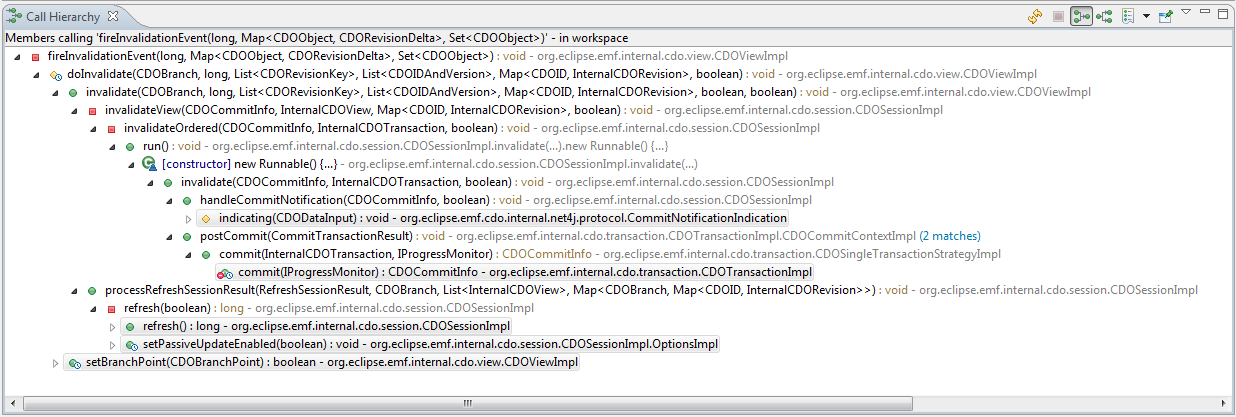

That has been asked on 09-18-2009 and I fear not much has changed in
this regard. The reason is that we don't have this piece of
information on the client in all cases. If fired the
CDOViewInvalidationEvent is always fired from
CDOViewImpl.invalidate() and calls this invalidate() method occur
for one of 4 reasons:<br>
<br>
<img src="http://www.eclipse.org/forums/index.php?t=getfile&amp;id=12984" alt=""><br>
<br>
1) remote commits while session.passiveUpdatesEnabled==true<br>
2) local commits<br>
3) manual refreshs while session.passiveUpdatesEnabled==false<br>
4) change of the view target<br>
<br>
Only in the first two cases the newObjects info is available. We
probably don't need/want it in the fourth cases. But there's still
the third one which is, conceptually, not that different from the
first one. It's a little like suspending the continuous, automatic
passive updates and doing active, batched updates instead from time
to time. This can only be efficient because the client asks the
server to send deltas for the currently loaded (viewed) objects.<br>
<br>
I wonder if we finally should try to provide the newObjects by
*some* means. As several people on the older thread already argued
this piece of information doesn't fit well with the original purpose
of the CDOViewInvalidationEvent (provide change info for
loaded/viewed objects). The only thing that speaks for this
particular event type is the delivery time, if compared to the time
the CDOSessionInvalidationEvent is delivered (which *does* carry the
newObjects info).<br>
<br>
Any thoughts?<br>
<br>
Cheers<br>
/Eike<br>

Thanks Eike. Now I know what to look for (CDOViewInvalidationEvent) I will search the forums for other references to it and gather more information. A quick look indicates that I can get object addition notifications if I set passiveUpdatesEnabled (as you've suggested) and register a listener. This seems like an "active" update. Is it called "passive" because I need to do something to pull the new and changed objects into the client cache?

Not sure what you mean. It's called "passive" because it causes model updates in/from a background thread that
represents the server.
