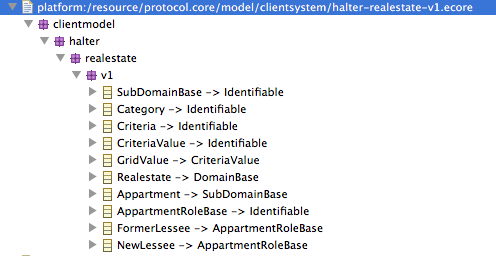

I am using nested model packages with the schema <mandator>.<application>.<version>.
To distinguish class names this is required at ecore model level not only at java package name level.
While decoding the qualified classname in ModelUtils.getEClassFromQualifiedName() the segment splitting with the QUALIFIERSEPARATOR is applied just once. Then ePackage.eNS_PREFIX is checked against the extracted qualifier.
In my case having multiple packages with nsprefix v1 this does not help to make the class name unique.
Suggestion split prefix into qualifier components then walk up the epackage hierarchy and check eNS_PREFIX for each component. Or use nsURI but this would break backward compatibility.

Hi Martin,
The model package names are generated. The last segment name is the version of the interface. So often two models will have the same version.
In the library sample there is only one package named library. If the package was org.texo.library then the attribute _eclass for Book should have the value org|texo|library|Book.
To assert the qualified model class each component of the package name org, texo and library should match with nsPrefix of the corresponding ecore class.
Hope could explain my point. If not I will try again with some sample code.
Donat
