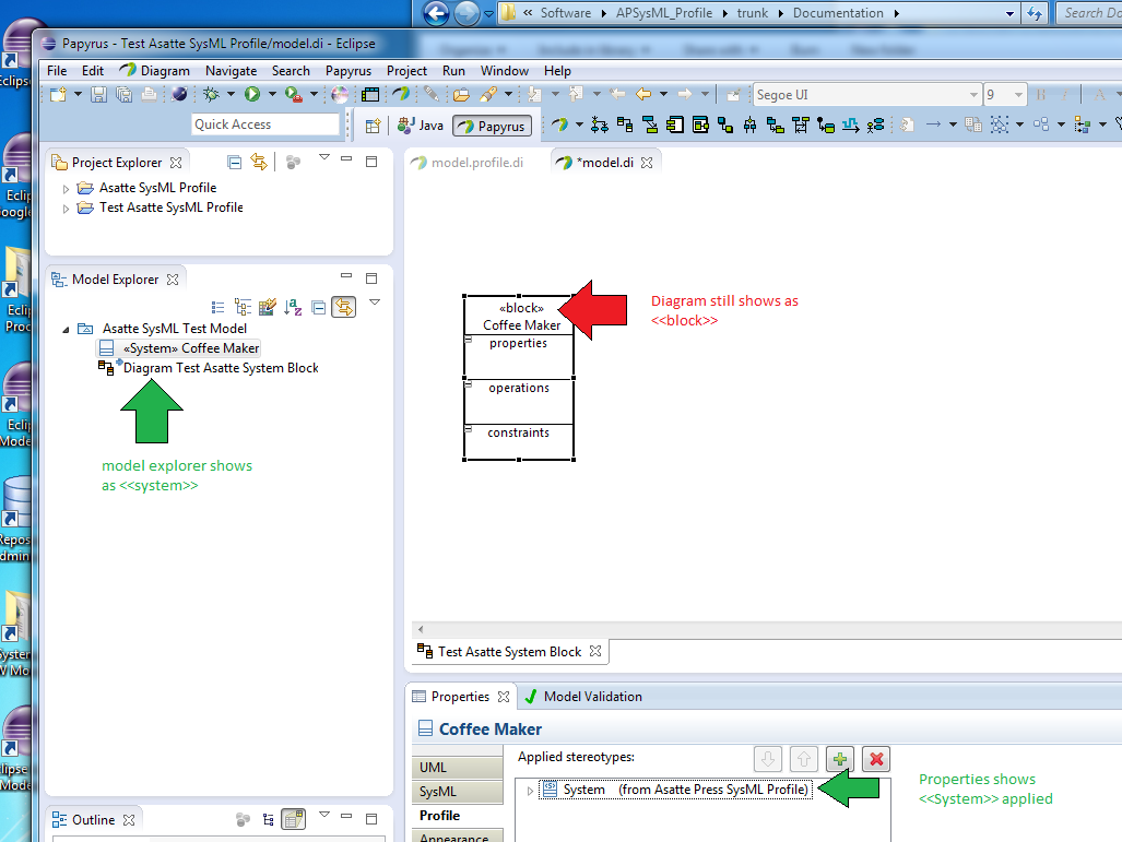

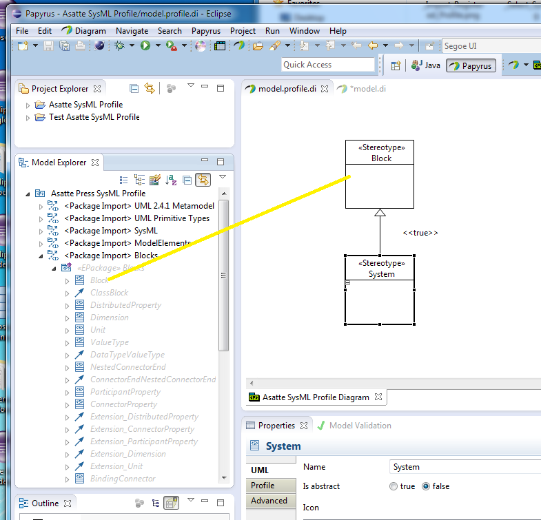

Re: extending requirement diagram in SysML [message #1103504 is a reply to message #1001498] Fri, 06 September 2013 18:11 Go to previous messageGo to next message
I am also interested in this subject. I would like to create a profile to create the <<System>> stereotype that you see in the first "System Context" diagram of every textbook. Using the original tutorial and the updated hints above, I was able to get this working almost perfectly but with one small remaining problem. Basically, I created my profile, imported the SysML profile, dragged a copy of the <<Block>> element onto my diagram, and then dragged a new stereotype onto the diagram. After naming the new stereotype <<System>> I added a generalization relationship to <<Block>>
index.php/fa/16131/0/
(See uploaded file: Asatte_SysML_Profile_System_Generalizes_Block.png)
So far, so good. However, when I then create a test model, add a block and apply the new profile (all of which works as described) it shows up nicely in the model explorer, but not in the actual diagram. Like thisL
index.php/fa/16130/0/
(See uploaded file: Not_OK_Diagram_Still_Shows_Block.png)
Looks like a (small) bug to me. Actually, I have a done step-by-step screen captures all the way from zero for this which I could drop into a Word document if that would be helpful... However, I am hoping that it is just something I missed...(?)
[Updated on: Fri, 06 September 2013 18:11] by Moderator
Re: extending requirement diagram in SysML [message #1104038 is a reply to message #1103504] Sat, 07 September 2013 15:28 Go to previous messageGo to next message
Hi, see p.29 of http://www.eclipse.org/papyrus/usersTutorials/resources/PapyrusUserGuideSeries_AboutUMLProfile_v1.0.0_d20120606.pdf
on how to display this graphically...

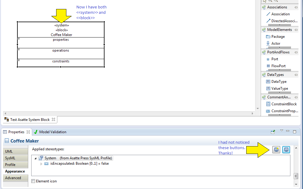

Re: extending requirement diagram in SysML [message #1105346 is a reply to message #1104038] Mon, 09 September 2013 14:29 Go to previous messageGo to next message
Thanks, that was helpful! I had not noticed the buttons in the upper right hand corner to toggle the appearance. Now, however, it shows both <<system>> (my new stereotype) and <<block>> (the stereotype it is derived from)
index.php/fa/16150/0/
Is there a way to suppress <<block>> and show only <<system>> (?)
