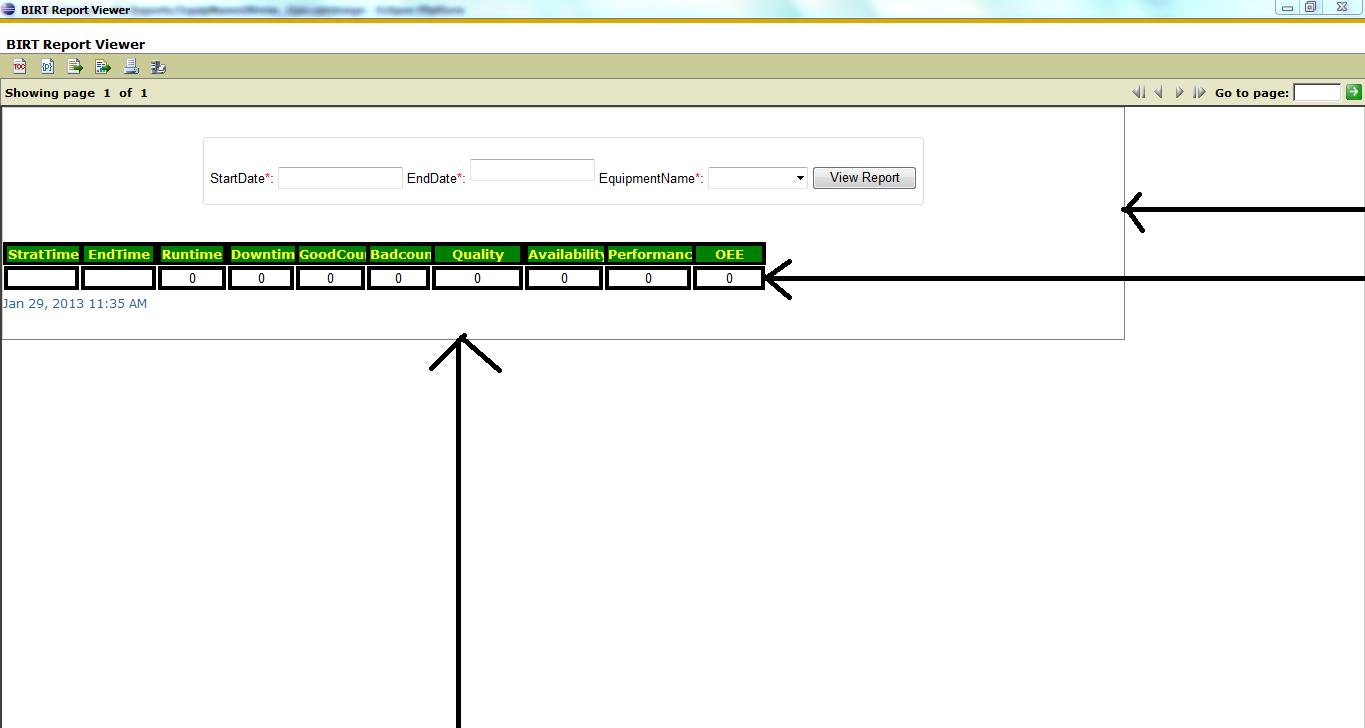

Re: How to pass the value of one data set into the another dataset? [message #1005860 is a reply to message #1005815] Tue, 29 January 2013 01:11 Go to previous messageGo to next message
I am attaching the screen shot of how the report is looking when I am viewing it in "webviewer" mode.
I have applied some black arrow marks to make you understand what is the exact problem of not covering the whole screen.

Re: How to pass the value of one data set into the another dataset? [message #1006032 is a reply to message #1005864] Tue, 29 January 2013 10:35 Go to previous messageGo to next message
For the not filling the page issue, you might try the auto layout. You can change this by selecting an empty spot in the report, then scrolling to the bottom of the general tab in the property editor.
I'll take a look at the other issue and let you know if I have troubles seeing it.
