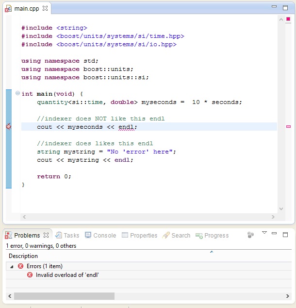

I'm working on Juno, with MinGW as the tool chain and Makefile project. I am also having this issue on a Linux box with Indigo. The code.jpg is a screen shot of my problem.
As you can see the endl is being picked up by the parser as an error. However everything compiles and executes without issues. I've tried the following:

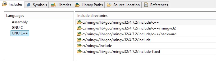

includes.jpg is a screen shot of my includes. Should I add anything to my Includes?

Re: Indexer not working with << operator [message #997524 is a reply to message #997311] Mon, 07 January 2013 21:16 Go to previous messageGo to next message
Does anyone else have this problem? This is the code you can copy and paste into eclipse:
#include <string>
#include <boost/units/systems/si/time.hpp>
#include <boost/units/systems/si/io.hpp>
using namespace std;
using namespace boost::units;
using namespace boost::units::si;
int main(void)
	quantity<si::time, double> myseconds = 10 * seconds;
	//indexer does NOT like this endl
	cout << myseconds << endl;
	string mystring = "No 'error' here";
	cout << mystring << endl;
	return 0;
Please Help!
Andrew

Re: Indexer not working with << operator [message #998036 is a reply to message #997876] Wed, 09 January 2013 03:43 Go to previous messageGo to next message
OK. I will reply you again after I download and install the boost API. I am using I am using Eclipse C/C++ IDE and MinGW Compiler tools.
Edit:
I tried to compile the code after succesfully installing boost library and got the same error you are getting i.e., "invalid overload of endl"
I think myseconds is not being converted to string.
[Updated on: Wed, 09 January 2013 04:35] by Moderator
Re: Indexer not working with << operator [message #998083 is a reply to message #997876] Wed, 09 January 2013 05:43 Go to previous messageGo to next message
Hi!
This code compiles fine.
#include <string>
int main(void)
	cout << myseconds;
	cout << endl;
	return 0;
