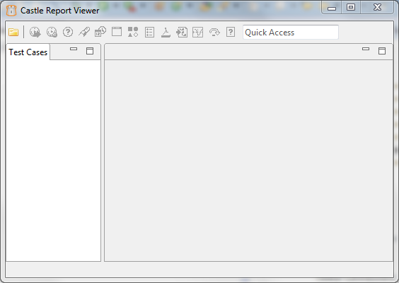

This is how the app look with 4.2
index.php/fa/12880/0/

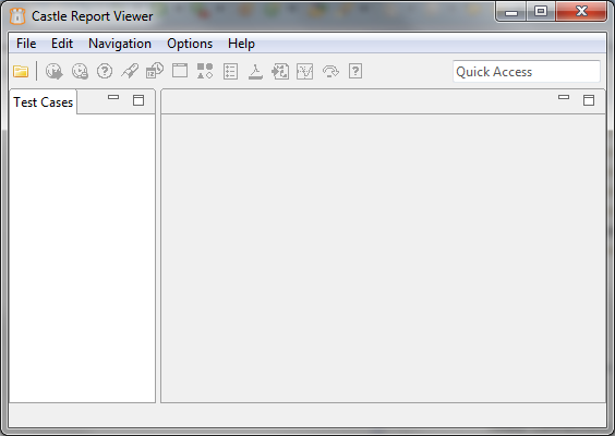

4.3M4, the quickaccess is strange
index.php/fa/12881/0/

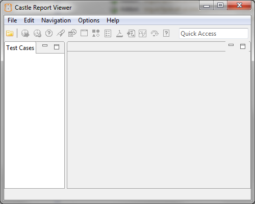

4.3M4, this is the resize needed to make the quick access flip so the upper line
index.php/fa/12882/0/

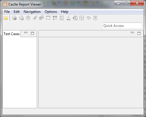

And again without -clearPersistedState the menu disapears
index.php/fa/12883/0/
Any ideas why the UI changes?
Any ideas what I can do about the clerarPersistedState?
