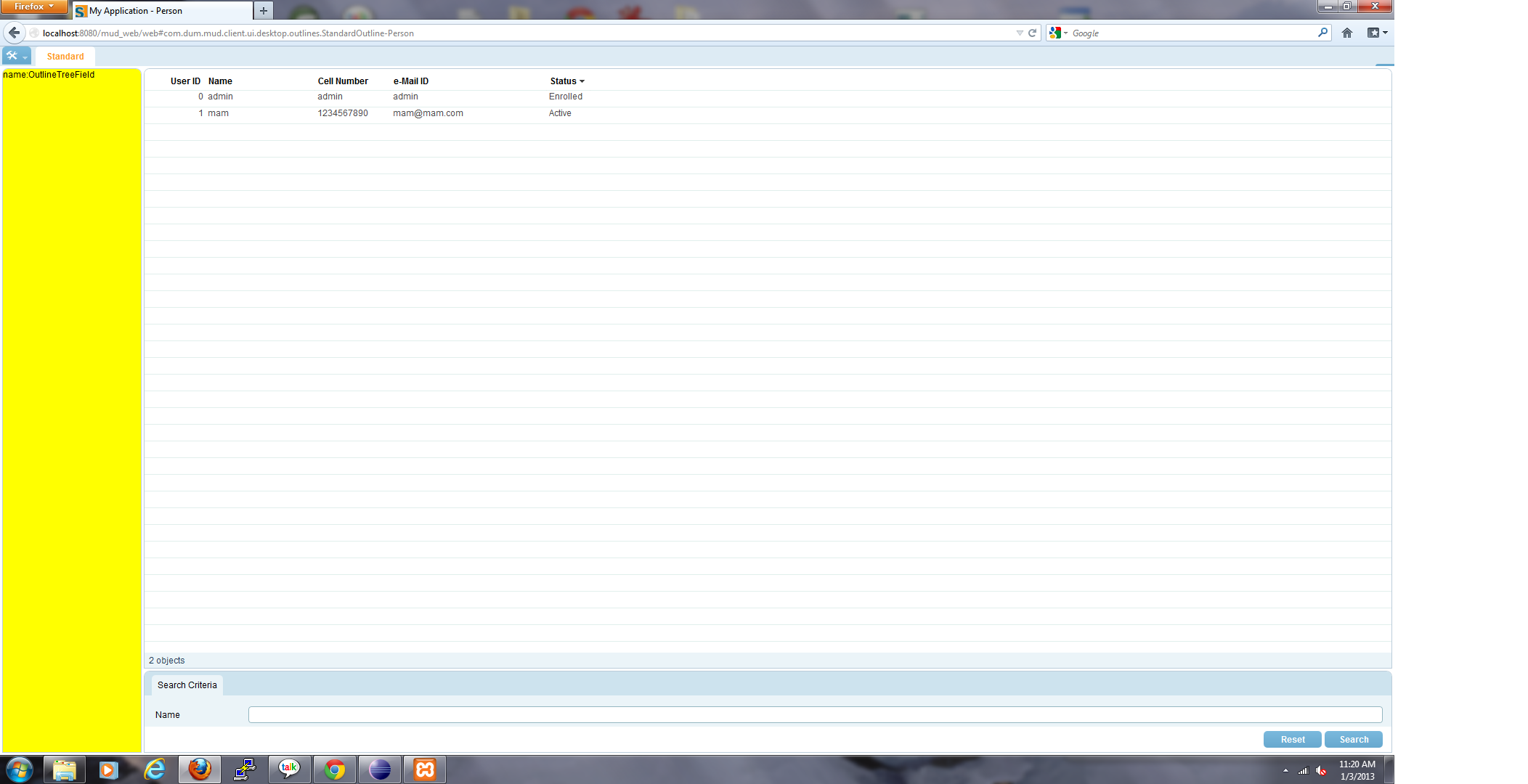

Thank you for the wonderful tutorial of Eclipse Scout. I am facing a problem after deployment of war files in Tomcat Server. I have followed all the steps as specified in the tutorials and extracted both, rap and server war files. Later I deployed them in Tomcat server. When I tried to access the client webpage i.e. rap, I am not getting the outline tree on the webpage. I have attached a screenshot with this post, the one with yellow highlighted towards left of the screen is where i am not getting the outline tree. Can you please give me some pointers for this problem.
Thank You in advance.

Re: Tomcat [message #996683 is a reply to message #996664] Wed, 02 January 2013 12:05 Go to previous messageGo to next message
A yellow placeholder component is a fallback when no renderer is found for the requested field.
An example: the PlannerField has only a Swing renderer... You get a yellow rectangle instead of a such field in a SWT application.
Your case is very strange, because I do not see why the OutlineTreeField cannot be rendered with RAP. (We have applications with pages and outlines rendered with RAP).

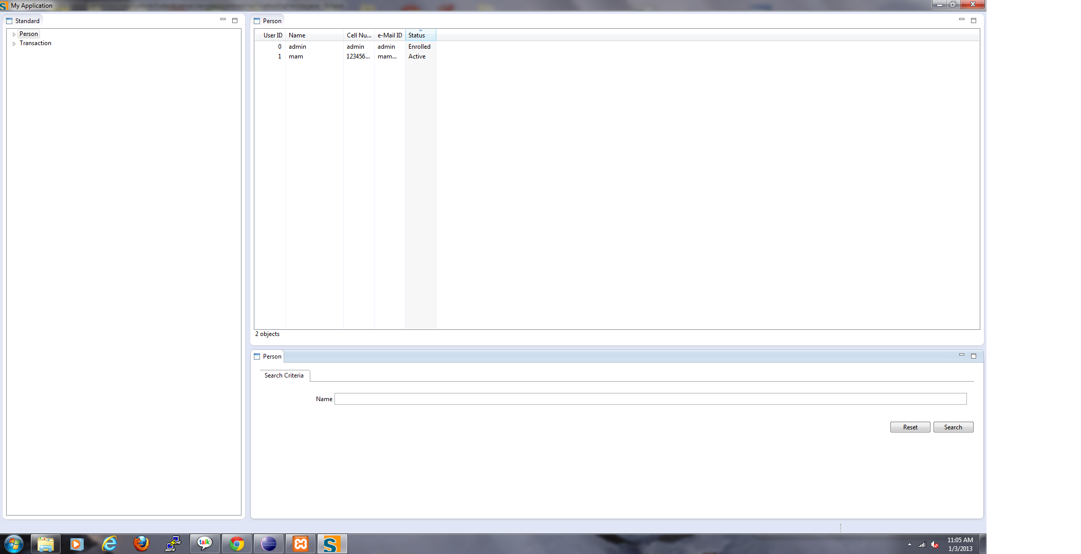

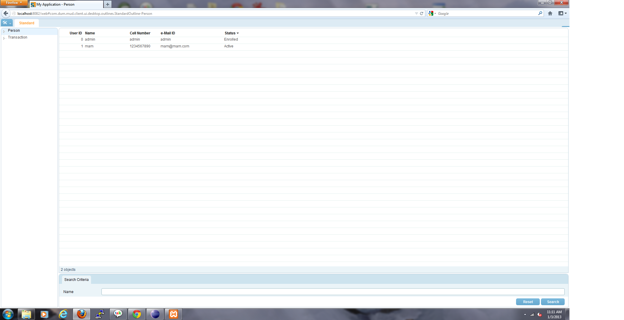

Re: Tomcat [message #996901 is a reply to message #996683] Thu, 03 January 2013 01:29 Go to previous messageGo to next message
Hi Jeremie,
Thank you for replying. In dev version using Jetty I am able to get outline tree in the rap version itself, even with the SWT environment it works. The Scout version which I am using is 3.8.1.201209171521. I am also attaching the screenshot with this post taken when the SWT and RAP were started in Dev environment and also Screenshot using the Tomcat server. My tomcat version is 7.0.21.
Thanks for your help

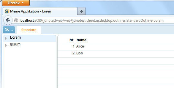

Re: Tomcat [message #997016 is a reply to message #996901] Thu, 03 January 2013 07:16 Go to previous messageGo to next message
I am not able to reproduce this:
* Scout: 3.8.1.201209171521
* Tomcat: apache-tomcat-7.0.23
* java version "1.6.0_25"
* Windows 7 Enterprise (Version 6.1 Build 7600)
index.php/fa/12872/0/
Have you try an other application (built from an other workspace)? an other Java version?
  • Attachment: tomcat.png
    (Size: 26.22KB, Downloaded 602 times)
