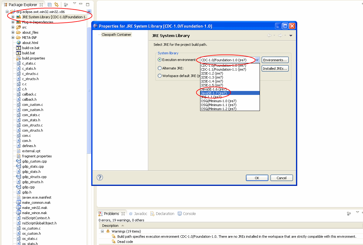

I opened org.eclipse.swt.win32.win32.x86 -> JRT -> execution environment and changed it to JRE1.7 SE.
Now this above problem is gone, but now i have 164 warnings....
(thats why i write, that i have no idea how to fix this problem).
and: this org.clipse.swt.win32.win32.x86 is imported for the tutorial.
See the attached png for what i changed.
The warnings all occur somewhere inside java rt like:
Description Resource Path Location Type
Class is a raw type. References to generic type Class<T> should be parameterized Display.java /org.eclipse.swt.win32.win32.x86/src/org/eclipse/swt/widgets line 1685 Java Problem
so the question is: how to correctly fix this problem?
best regards,
mario.
