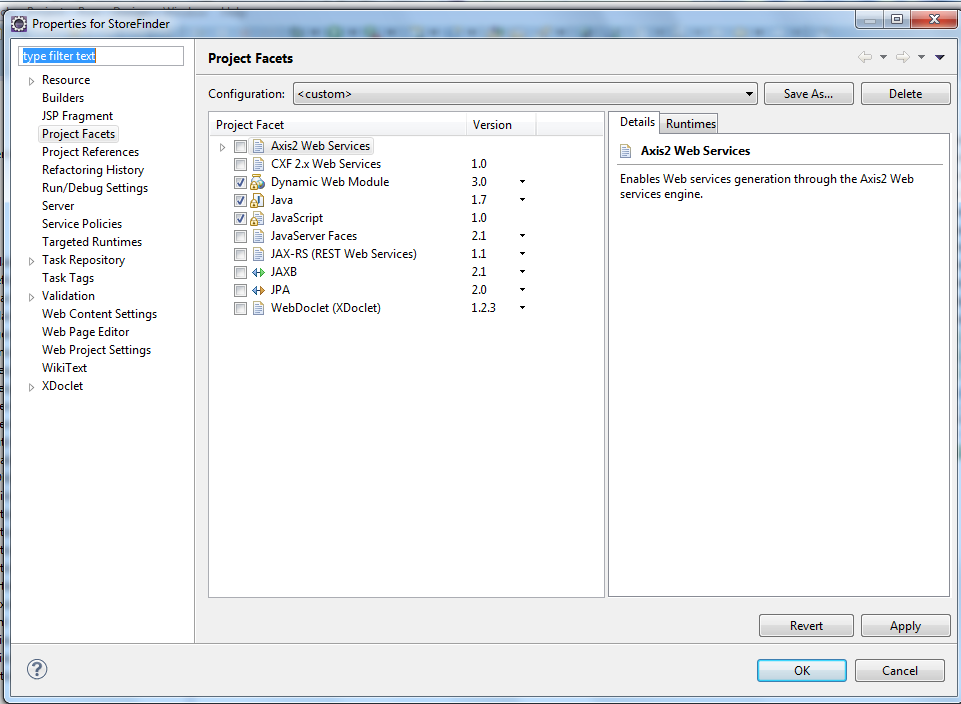

Re: Project importing existing web app into Eclipse [message #995277 is a reply to message #995079] Sat, 29 December 2012 11:17 Go to previous messageGo to next message
Roberto,
Thanks for the helpful tips, I appreciate it. My project does have that facet, and those files in the correct location as far as I can tell. When I try to export the project as a WAR file both of the drop downs are empty - I'm attaching a screen shot of what I get. Should the web app product a jar file as part of the build, or is there some other preliminary build step that might not be finishing that thwarts recognition of my code as a web app?
Thanks again for anybody who might have some ideas. I'm really looking forward to working on this stuff if Eclipse if I can get the project setup going.
Happy New Year everybody,
George

Re: Project importing existing web app into Eclipse [message #997503 is a reply to message #995277] Mon, 07 January 2013 15:26 Go to previous message
By looking at the properties page of the project, I see that several tabs are missing, for example, Deployment assembly and Java Build Path, among others. This suggests that important files like .classpath and other files inside the .settings folder (in .settings, there are really important files for web projects) are missing. These files and folders are located at the root of the project.
I suggest to check if the .classpath file exists, and to check which files exist under .settings (if you can, provide the list of files). I suspect .settings is not empty, because the file org.eclipse.wst.common.project.facet.core.xml, which has information for the project facets, lives in there, and you can see the project facets).
