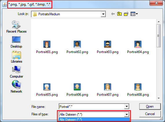

I am using a FileChooser in two places. In one place I directly create a new FileChooser instance as described in this thread. In the other place I use a FileChooserField in a form.
In both cases I am able to set the default path, the default file name, the file extensions to use in the extension drop down box.
However, I think the default file chooser is ugly as sin, so I added the following code to my SwingEnvironment class to use the native windows file dialog instead:
  public ISwingScoutFileChooser createFileChooser(Window w, IFileChooser fc) {
    ISwingScoutFileChooser ui = new SwingScoutFileChooser(this, fc, w, true);
    decorate(fc, ui);
    return ui;
This works and lets me use the windows file dialog, however, it seems that this ignores any parameters I set on the file chooser.
  • I cannot set a default directory (it seems the file dialog under windows 7 manages that on its own)
  • I cannot set the extension for the extension drop down box (I always have the single entry "All files (*.*)" in there. Instead, the extension I define are used as title text for the FileDialog
  • I does honour the filename that I set
Is there something more I need to do to make sure the FileChooser.setXxxx() methods have an effect for the native (AWT) file chooser? If not, I can live with not being able to set a specific directory and just having the file dialog use the last one I selected a file from. I can live with not being able to populate the extension filter dropdown, but the extensions showing in the title bar is truly annoying!
index.php/fa/12751/0/
Is there a way to get rid of the extensions from the title bar?

When I check the code in SwingScoutFileChooser, I think the title is created the way you describe (StringBuffer buf) and cannot be changed without changing Scout Code. Of course you could always create your own SwingScoutFileChooser and return it in SwingEnvironment.
      StringBuffer buf = new StringBuffer();
      if (extensions != null) {
        for (int i = 0; i < extensions.length; i++) {
          if (i > 0) {
            buf.append(", ");
          buf.append("*." + extensions[i]);
      if (buf.length() == 0) {
        buf.append("*.*");
      if (m_owner instanceof Dialog) {
        dlg = new FileDialog((Dialog) m_owner, buf.toString(), openMode ? FileDialog.LOAD : FileDialog.SAVE);
      else if (m_owner instanceof Frame) {
        dlg = new FileDialog((Frame) m_owner, buf.toString(), openMode ? FileDialog.LOAD : FileDialog.SAVE);
      else {
        dlg = new FileDialog(new Frame(), buf.toString(), openMode ? FileDialog.LOAD : FileDialog.SAVE);
Adrian

Thanks for your suggestion, I've been able to fix the title problem using this approach. It's a shame that SwingScoutFileChooser.showFileChooserSwing and SwingScoutFileChooser.showFileChooserAWT are private, otherwise it would have been very easy to just have my own file chooser inherit from SwingScoutFileChooser and then overwrite showFileChooserAWT. On the other hand, the class is not so big that having an almost 1:1 copy of the code will be a huge problem.
However, it seems that there is no way to adjust the file extension filter dropdown content for the AWT version of the file chooser (but I can live with that limitation).
