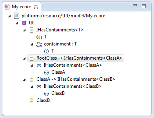

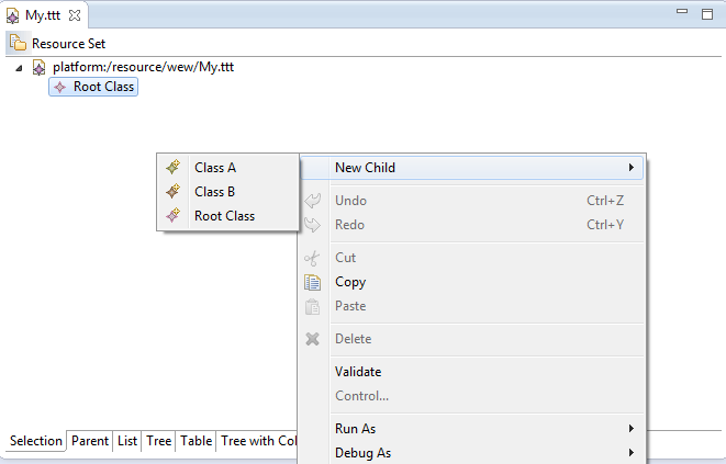

With java generics the default editor behaves strangely.
Was it bad idea to encapsulate containment reference to generic?
index.php/fa/12757/0/
The containments of classes: RootClass -> ClassA -> ClassB
index.php/fa/12758/0/
Generated code seems to be correct, but the editor behaves strangely.
The main strange thing - RootClass has
protected EList<ClassA> containment;
but I can add ClassB to List.
Dmitriy

Re: EMF and Java Templates [message #992835 is a reply to message #992241] Sat, 22 December 2012 14:40 Go to previous message
Dmitriy,
There are open bugzillas that we don't constrain the children in a way
that takes generics into account, i.e., this feature in the erased model
is of type EObject, so we allow any EObject, which in a RootClass
instance, isn't restricted enough. Sorry, I've not had time to address
this yet...
