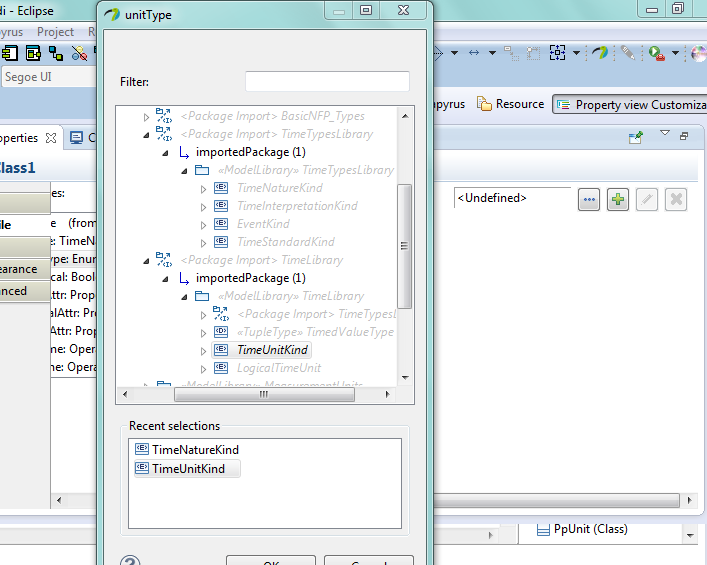

Re: import registered package [message #1009289 is a reply to message #992312] Thu, 14 February 2013 15:43 Go to previous messageGo to next message
Hi Camille,
when i try to specify the properties of a stereotype such as "unit type" of "clocktype "stereotype i specify it through properties view and then press .. button to select "time unit kind" from the imported MARTE library
see attachment
Does those steps right?
i know how to apply registered profile (MARTE)but don't know how to apply MARTE library?
