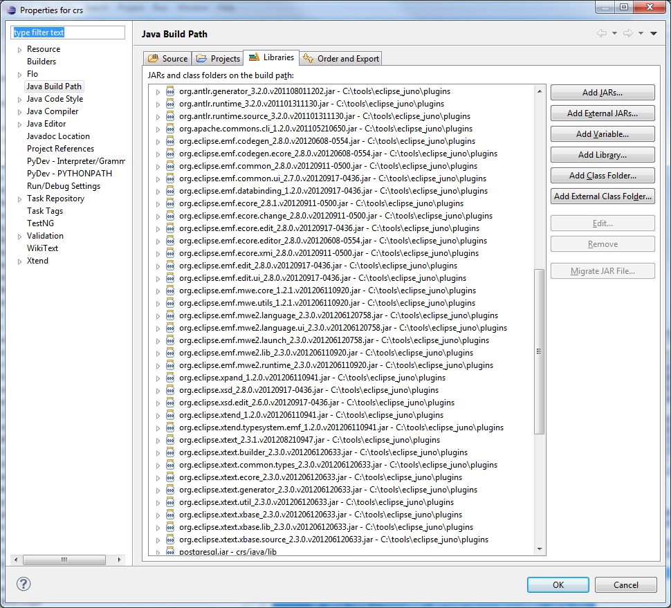

I'm trying to run standalone setup as
import org.eclipse.xtext.generator.IGenerator;
import com.google.inject.Injector;
public class MainGen {
		Injector i = new FloStandaloneSetup().createInjectorAndDoEMFRegistration();
		IGenerator generator = i.getInstance(IGenerator.class);
I'm getting such exception
Caused by: java.lang.SecurityException: class "org.eclipse.xtext.parsetree.reconstr.impl.DefaultHiddenTokenHelper$$FastClassByGuice$$db42f815"'s signer information does not match signer information of other classes in the same package
at java.lang.ClassLoader.checkCerts(ClassLoader.java:943)
at java.lang.ClassLoader.preDefineClass(ClassLoader.java:657)
at java.lang.ClassLoader.defineClass(ClassLoader.java:785)
... 139 more
I think it it related to different versions but I don't understand what versions I should use. Can someone help with this. I attached list of libs I use.
index.php/fa/12656/0/
Thank you
  • Attachment: libs.jpg
    (Size: 376.66KB, Downloaded 493 times)

Hi Igor,
which version of Xtext do you use? Please make sure that you use the
google inject bundle that ships with Eclipse.
Sebastian

The problem is solved by downloading and installing eclipse from scratch
