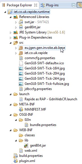

My RAP application is the 'iet.co.uk.rapide' one, which references a set of classes starting 'ca.com.gen80.*'. These are in a single JAR called 'gen80rt.jar'.
Where should I be specifying the gen80rt.jar so that my RAP app can find it at runtime? gen80rt.jar is not a Plug-in or a Bundle, just a totally stand-alone JAR file. There doesn't appear to be a concept of a CLASSPATH for RAP applications (apart from the Bundle's Classpath that I've included further down in this post), which sort of makes sense since they have to define precisely what they export and what they import in the manifest, but how to actually reference this JAR?
Perhaps this is very basic, and I'm missing something fundamental, so please be patient while I get my head around it all!
I've placed gen80rt.jar into WEB-INF/lib by the way.
Basic project structure as below:

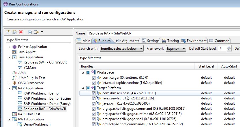

In my original RAP project where I want to use this JAR, I've added a dependency to it as follows:
index.php/fa/12638/0/
I then modify my RAP Run Configuration to include this new Bundle:
index.php/fa/12639/0/
Unfortunately nothing has changed. The browser gives the same as previous:

...and ss in OSGi console gives:
ss
"Framework is launched."
id	State       Bundle
0	ACTIVE      org.eclipse.osgi_3.9.0.v20121026-132713
	            Fragments=5
1	ACTIVE      org.eclipse.core.runtime_3.9.0.v20121004-163638
2	ACTIVE      org.eclipse.rap.rwt_2.0.0.20121112-1148
3	ACTIVE      org.eclipse.rap.ui.workbench_2.0.0.20121106-1948
4	ACTIVE      org.apache.felix.gogo.command_0.8.0.v201108120515
5	RESOLVED    org.eclipse.equinox.servletbridge.extensionbundle_1.2.100.v20120522-2049
	            Master=0
6	ACTIVE      com.ca.gen80.runtimes_8.0.0
7	ACTIVE      org.eclipse.rap.ui.views_1.5.100.20121031-1050
8	ACTIVE      org.eclipse.jetty.io_8.1.3.v20120522
9	ACTIVE      org.eclipse.equinox.registry_3.5.300.v20120731-134527
10	ACTIVE      org.eclipse.equinox.app_1.3.100.v20120522-1841
11	ACTIVE      org.eclipse.help_3.6.0.v20120521-2344
12	ACTIVE      org.eclipse.jetty.continuation_8.1.3.v20120522
13	ACTIVE      org.eclipse.equinox.http.servlet_1.1.300.v20120912-125810
14	ACTIVE      org.eclipse.equinox.console_1.0.100.v20121001-124408
15	ACTIVE      org.apache.felix.gogo.shell_0.8.0.v201110170705
16	ACTIVE      javax.xml_1.3.4.v201005080400
17	ACTIVE      iet.co.uk.rapide.runtime_1.0.0.qualifier
18	ACTIVE      org.eclipse.rap.jface.databinding_2.0.0.20121031-1050
19	ACTIVE      org.apache.felix.gogo.runtime_0.8.0.v201108120515
20	ACTIVE      org.eclipse.equinox.http.jetty_3.0.0.v20120522-1841
21	ACTIVE      org.eclipse.jetty.servlet_8.1.3.v20120522
22	ACTIVE      com.ibm.icu.base_4.4.2.v20110831
23	ACTIVE      org.eclipse.core.databinding.observable_1.4.1.v20120521-2329
24	ACTIVE      org.eclipse.equinox.preferences_3.5.0.v20120918-182152
25	ACTIVE      org.eclipse.jetty.http_8.1.3.v20120522
26	ACTIVE      javax.servlet_3.0.0.v201112011016
27	ACTIVE      org.eclipse.jetty.server_8.1.3.v20120522
28	ACTIVE      org.eclipse.osgi.services_3.3.100.v20120522-1822
29	ACTIVE      org.eclipse.core.jobs_3.5.300.v20120912-155018
30	ACTIVE      org.eclipse.core.databinding_1.4.1.v20120912-132807
31	ACTIVE      org.eclipse.core.databinding.beans_1.2.200.v20120523-1955
32	ACTIVE      org.eclipse.jetty.security_8.1.3.v20120522
33	ACTIVE      org.eclipse.jetty.util_8.1.3.v20120522
34	ACTIVE      org.eclipse.core.contenttype_3.4.200.v20120523-2004
35	ACTIVE      org.eclipse.rap.rwt.osgi_2.0.0.20121031-1050
36	ACTIVE      org.eclipse.rap.ui.forms_1.5.100.20121105-1308
37	ACTIVE      org.eclipse.equinox.http.registry_1.1.200.v20120912-125810
38	ACTIVE      org.eclipse.core.commands_3.6.1.v20120814-150512
39	ACTIVE      org.eclipse.core.expressions_3.4.401.v20120912-155018
40	ACTIVE      org.eclipse.rap.ui_2.0.0.20121105-1706
41	ACTIVE      org.eclipse.core.databinding.property_1.4.200.v20120824-092539
42	ACTIVE      org.eclipse.equinox.common_3.6.100.v20120522-1841
43	ACTIVE      org.eclipse.rap.jface_2.0.0.20121031-1050
44	ACTIVE      org.eclipse.rap.design.example_1.5.100.20121109-0718
osgi>
You can see both my Bundles as ACTIVE (at number 6 and 17 in the above example).
So, why can't my 'rapide' RAP application see the runtimes within gen80rt.jar (in the com.ca.gen80.runtimes Bundle)?
Please help, I'm going headless chicken with this not understanding what I'm missing!
Many thanks, John
Re: ClassNotFoundException in OSGi but jars included [message #989776 is a reply to message #989723] Fri, 07 December 2012 12:07 Go to previous messageGo to next message
John,
ideally you would create an OSGi bundle from the gen80 library. Google
for "use library jar in osgi" or so and you'll find plenty of advise.
Alternatively you can extend the class-path of the bundle that contains
the gen08 library like so
Bundle-ClassPath: .,ren08rt.jar
and make sure that the library is listed in the build.properties file
like so:
bin.includes = .,META-INF/,gen08rt.jar
As you said that your application runs ok as SWT Standalone, are you
aware that you don't *have* to use OSGi. RWT, the SWT for the web part
of RAP, runs just fine without OSGi. See the FAQ [1] and the developer's
guide [2] for more.
HTH
Rüdiger
[1]
http://wiki.eclipse.org/RAP/FAQ#How_do_I_develop_an_RWT_standalone_application_with_RAP_.3E.3D_1.5
[2] http://eclipse.org/rap/developers-guide
> Where should I be specifying the gen80rt.jar so that my RAP app can find it at runtime? It is not a Plug-in or a Bundle, just a totally stand-alone JAR file. There doesn't appear to be a concept of a CLASSPATH for RAP applications (apart from the Bundle's Classpath that I've included further down in this post), which sort of makes sense since they have to define precisely what the export and what they import in the manifest, but how to actually reference this JAR?
> I've placed gen80rt.jar into WEB-INF/lib by then way.

> My Manifest looks like this:
> Manifest-Version: 1.0
> Bundle-ManifestVersion: 2
> Bundle-Name: %Bundle-Name
> Bundle-SymbolicName: iet.co.uk.rapide.runtime;singleton:=true
> Bundle-Version: 1.0.0.qualifier
> Bundle-Vendor: %Bundle-Vendor
> Import-Package: iet.co.uk.rapide,
> org.eclipse.rap.rwt.application;version="2.0.0",
> org.eclipse.rap.rwt.lifecycle;version="2.0.0",
> org.eclipse.rap.rwt.widgets;version="2.0.0",
> org.eclipse.swt,
> org.eclipse.swt.events,
> org.eclipse.swt.graphics,
> org.eclipse.swt.layout,
> org.eclipse.swt.widgets
> Bundle-RequiredExecutionEnvironment: JavaSE-1.6
> Export-Package: iet.co.uk.rapide;
> uses:="com.ca.gen80.vwrt.vdf,
> eu.jgen.gen.invoke.ab.base,
> org.eclipse.rap.rwt.application,
> org.w3c.dom,
> org.eclipse.swt.ole.win32,
> com.ca.gen80.abrt,
> com.ca.gen80.csu.exception,
> com.ca.gen80.vwrt,
> org.eclipse.rap.rwt.lifecycle,
> org.eclipse.equinox.app,
> org.eclipse.swt.widgets"
> Require-Bundle: org.eclipse.rap.ui
> WEB-INF/lib/gen80rt.jar

Thanks Rüdiger,
I do indeed have the application running as SWT Standalone, and also RWT Standalone, but wanted to get it going under OSGi as RAP because eventually I want to be able to take it to Tabris, and I thought that RAP was a necessary step to get there i.e. it must work under RAP, otherwise forget Tabris...? Have I misunderstood?
I've had a little play with the settings that you suggested for RAP, but nothing working yet... will continue to experiment, but would appreciate any further suggestions to make gen80rt.jar visible to the running RAP application.
Many thanks, John

Have moved on a little... I got suspicious when it transpired that other classes within that JAR (gen80rt.jar) were being found ok, and realised that ABBase was being loaded via programmatic class loader:
myABClass = myClassLoader.loadClass(className);
So, I modified my ClassLoader to include the gen80rt.jar at runtime, hard-coded for now from a specific path:
try {
  myClassLoader.addURL(new URL("file:" + appRoot + "/gen80rt.jar"));
} catch (MalformedURLException e) {
  e.printStackTrace();
Great, this gets around that issue, but now I have other unexpected issues with other classes in the jar, not being able to cast them as I did in SWT/RWT:
