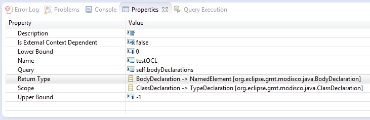

If your MoDisco query is returning a list of elements, you should set it via the Lower Bound and Upper Bound fields of your query declaration (cf. the attached snapshot showing an OCL query example defined for Java models).
In any case, the Return Type should be the actual type of elements returned by the query.

Thanks. That works.
