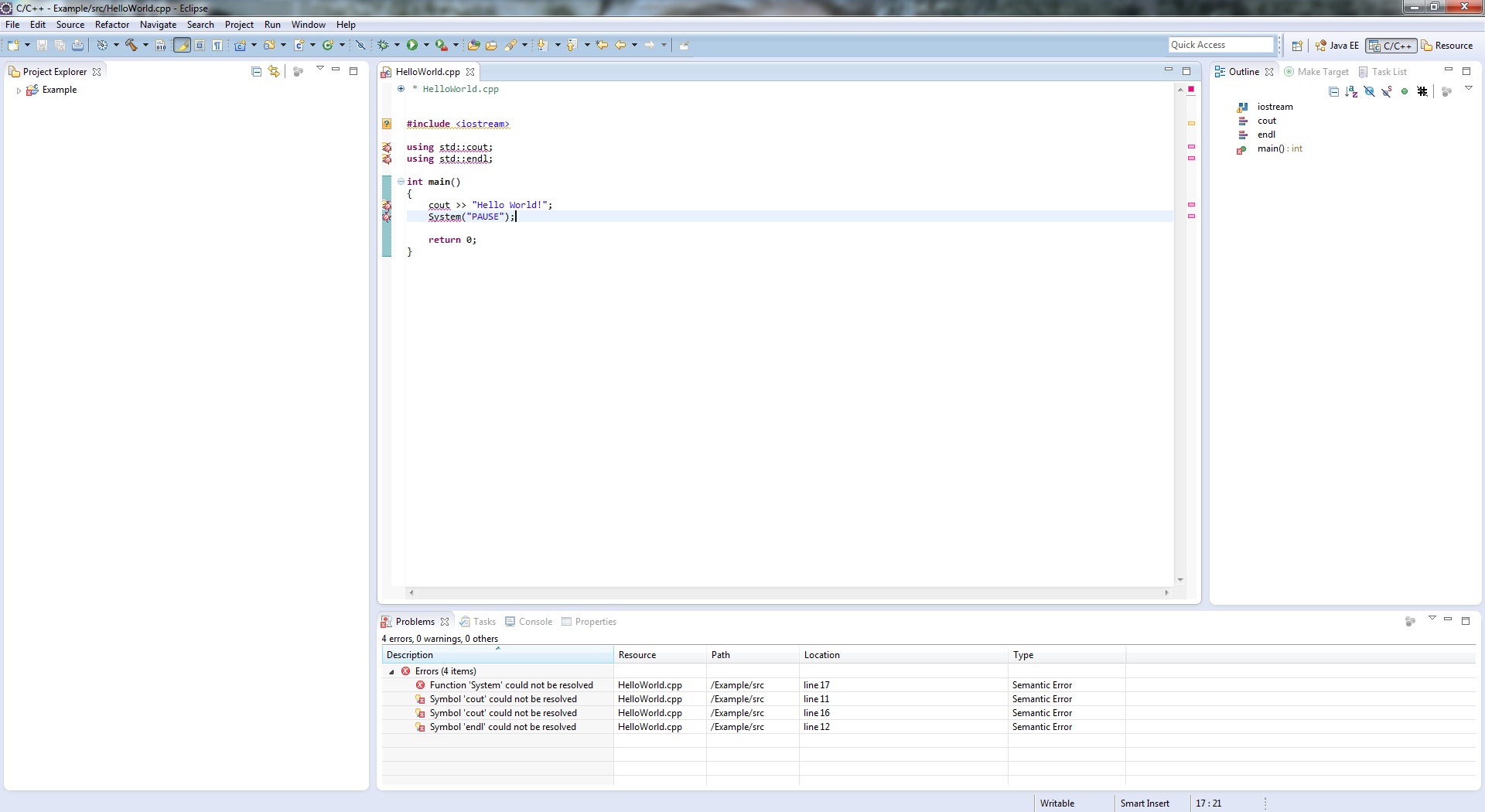

I have Eclipse Juno installed and the CDT properly configured (To my knowledge) with the CDT and it is connected to the MinGW compiler (Other issue I fixed myself).
However I'm getting a Unresolved Inclusion error in a simple Hello World program
Screenshot included:
I'm all out of ideas and I can't seem to find decent support for Juno so if someone knows how to fix this issue I'd be glad to hear it! Thanks in advance!

The reason why "System" is unresolved is because there is no such function... it must be all lowercase.
As for why the inclusion is unresolved, I'm unsure why automatic discovery did not work for you (and I do not have it installed on a Windows machine to test out), maybe someone else will be able to help. However, you should be able to add the path to MinGW's includes by right-clicking on the project, which will take care of your other errors.
Note that once you change the case of System, if you actually build it, it should build and run fine.

* look in project properties and see if the preprocessor includes has the "language settings provider" enabled.
** check if the includes folder in your project lists all compiler-provided include paths
* Try Index-Rebuild (if that doesn't take some time as a background process, restart eclipse and try again.
** there seems to be a glitch in Juno that prohibits the indexer running when you import or copy a project
BTW, you can use visual studio's compiler cl.exe if you set up your project and select the microsoft toolchain.
Peter.
