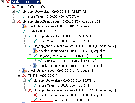

Hello, could you please evaluate the next problem.
Simple scenario:
1. Create keyword TEMP1:
- assign variable TEST1 value 1
- check if variable $TEST1 equals 2
EH on check failed:
- Retry attempts = 1
2. Create test case TEMP:
- assign variable ATEST value 'B'
- check if variable $ATEST equals 'B'
EH on check failed:
- run TEMP1 keyword
- Retry attempts = 10
Run test case TEMP.
Expected: EH keyword TEMP1 is executed 10 times. EH for keyword TEMP1 is also executed 10 times.
Problem: EH keyword TEMP1 is executed 10 times. EH for keyword TEMP1 is only executed 1 time.
Please check attached:
index.php/fa/12624/0/
  • Attachment: Jubula_EH.PNG
    (Size: 17.86KB, Downloaded 417 times)

it looks like you're running into this issue. The workaround would be to set the retry count higher so that it doesn't "run out".
Hope that helps!
Alex

Yes, this is the same issue that I ran into while exploring how to make Jubula to navigate the tree to find a node by some criteria, and used that workaround also.
However for trees that a more than small' using of a big retry count can become a headache in case of some logic corruption in a keyword or a bug in application.
So, hope the isssue will be fixed soon.
Alex.
