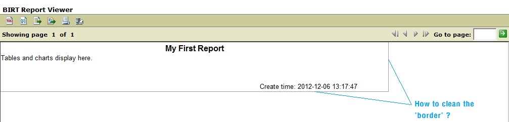

I'm new in BIRT.
I can show birt report in web browser using frameset way to display page break.
However, It appears a 'border' in web browser, my clients can not to accept it. When I designed the report, i was not used any borders in my reports at all. I made a simple demo as below.
index.php/fa/12620/0/
I modified the css file(webcontent\birt\styles\style.css) to clean the 'border'. Details as below:
.birtviewer_document_fragment
overflow:auto;
position:relative;
border-style: solid;
border-width: 2px;
border-top-color: #404040;
border-left-color: #404040;
border-right-color: #D0D0D0;
border-bottom-color: #D0D0D0;
overflow:auto;
position:relative;
border-style: none;
border-width: 0px;

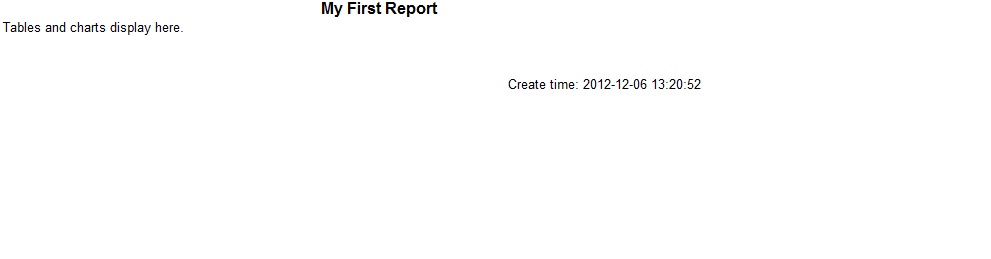

But, I failed. So I am eager to know how to clean the 'border', like this
index.php/fa/12621/0/
I greatly appreciate all help.
Thanks.

I had tried it before you gave this suggestion, but it didn't work. So I modified the .CSS file(as above), the border was still there. I am confused, there isn't any border in the repor, and i modify the .CSS file, why the border is still there?

Re: How to clean 'Border' in web browser using frameset way? [message #989626 is a reply to message #989624] Thu, 06 December 2012 23:32 Go to previous messageGo to next message
In the designer, I used 'View Report in Web Viewer' to preview the report, the border appears. When I userd 'View Report as HTML' to preview the report, there is no borders in the report.
Re: How to clean 'Border' in web browser using frameset way? [message #989627 is a reply to message #989626] Thu, 06 December 2012 23:35 Go to previous messageGo to next message
I deployed the report in a web application in Tomcat. I used the URL(.../MyApp/frameset?__report=MyFirstReport.rptdesign&__showtitle=false&__toolbar=false) to access the report. The border appears as you see the above picture. So, I want to know how to clean the border? Modify the sourse files or change the URL parameters?
Re: How to clean 'Border' in web browser using frameset way? [message #989808 is a reply to message #989627] Fri, 07 December 2012 18:53 Go to previous messageGo to next message
For the record, I only see this in IE. This doesn't happen in FF or Chrome. I've not pinned it down, quite yet, but a workaround is that you can set the border for your masterpage to be white and it will cover up whatever that border is, in IE. I'll let you know if I figure out what's causing it.
