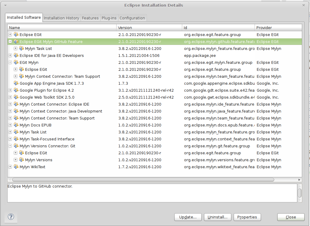

I'm new to git and mylyn, trying to use egit and mylyn with github. Have gotten most things working, but unable to create a Mylyn remote repository that connects to my github repo issues. Here is my installed Eclipse software.

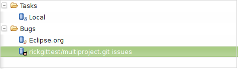

- The task repository was created, as shown here:
index.php/fa/12610/0/
Note the decorator icon used by Eclipse on the repository (I don't know what it means).
- I selected 'Synchronize All Tasks' from the context menu of the newly created Bugs Repo and nothing seems to happen. Shouldn't the issue I created in github be retrieved and shown?
- I then tried to create a New Task for the remote issues repository. I filled out the short description at the top of the dialog, the description field, and set the assignee to myself (my github userid).
- When I press the submit button, I get an error message, "Submit failed: Unexpected error: Not Found". When I click on the error message, I get no additional information.
I could really use some help to get past this problem. Thanks in advance.
Re: Problem connecting Mylyn remote repo with github issues repo [message #989336 is a reply to message #989335] Wed, 05 December 2012 11:59 Go to previous messageGo to next message
Edit the task repository and remove the .git suffix from the Server field.
Re: Problem connecting Mylyn remote repo with github issues repo [message #989352 is a reply to message #989336] Wed, 05 December 2012 14:14 Go to previous message
That worked. Thanks! I also discovered that I needed to create a Query in order to pull tasks from the github server to Eclipse.
