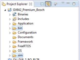

Here is my project structure (also as attachment):
index.php/fa/12593/0/
'bin' and 'sim' are in the SAME project parallel by the source folders.
The 'Source Location' for BOTH build configs would therefore be 'GV642_Premium_Bosch' !?!?

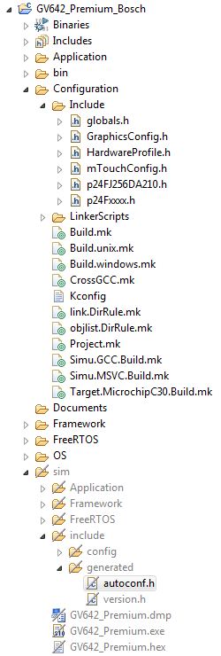

This screenshot is the situation directly after the last 'F3':
index.php/fa/12630/0/
Even as 'autoconf.h' is (obviously) excluded, it is highlighted and opened in an editor. Confused

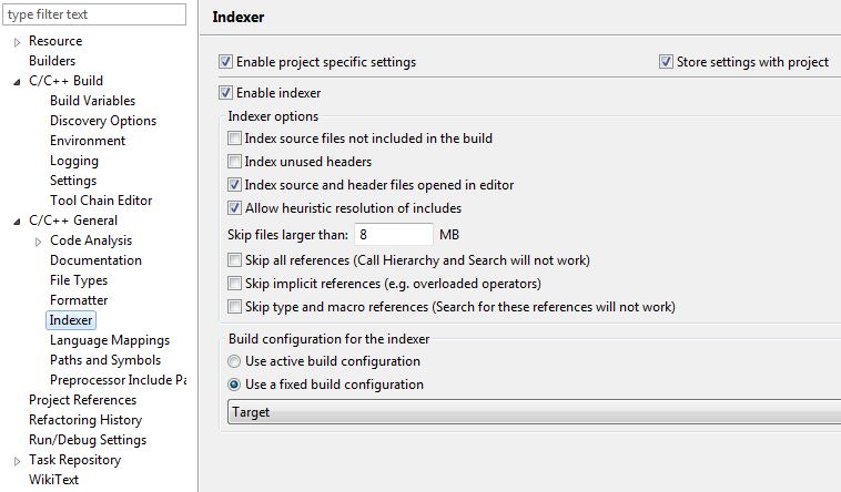

And here are the 'Indexer' settings in the PROJECT:
index.php/fa/12631/0/
Is there the possibility of a bug in CDT?
My only way to get it working properly is to RENAME the 'sim' folder and 'Rebuild Index'.
