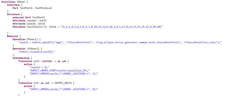

Code and explanations (ChoicePointTest.room):
index.php/fa/12581/0/
- Constructor and Destructor open and close the testcase. You have to memorize the caseId. Be aware that this testcase is a pure whitebox test for testing the codegenerator by generating, compiling and running the code (in case you wonder about this useless statemachine)
- Then you can use the EXPECT_ functions more or less like in JUnit -> a failed EXPECT will not end the testcase, but will stop the reporting (e.g. to avoid problems with EXPECTS in loops)

- the EXPECT_ODER is something special for testing the order of execution of code fragements. We use it e.g. for testing the order of entry, exit, action codes in hierarchical FSMs with history (not a simple task). The resultlist defines the order.
