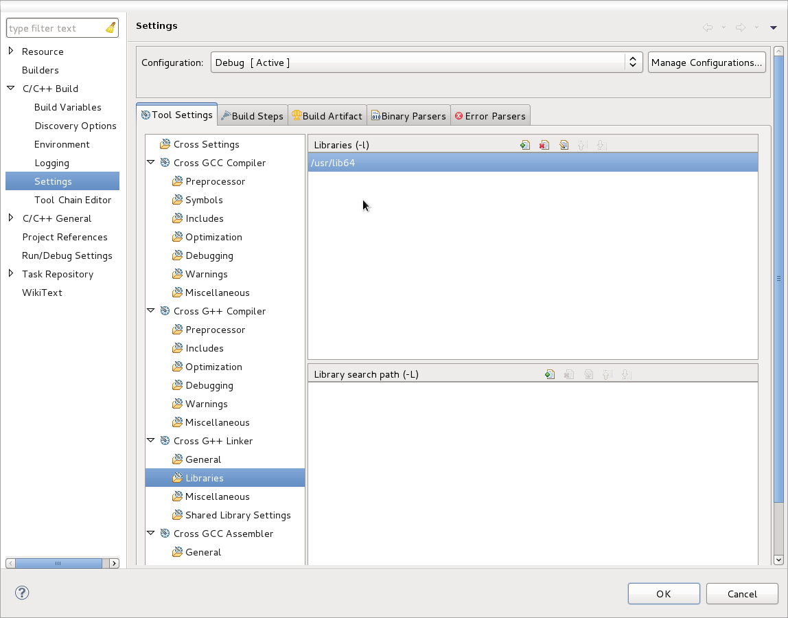

Re: Eclipse cannot find already included libraries ? (Desparate for help) [message #989281 is a reply to message #988620] Wed, 05 December 2012 09:02 Go to previous messageGo to next message
Ok that didn't help either.
The guide is refering to an older version, however i did what I could:
Project properties > C/C++ Build > Settings > Tool Settings > Cross G++ Linker > Libraries > Add (-l) > /usr/lib64
Now Im getting this error:
13:40:56 **** Incremental Build of configuration Debug for project hello_malaka ****
make all
Building target: hello_malaka
Invoking: Cross G++ Linker
g++  -o "hello_malaka"  ./hello.o   -l/usr/lib64
/bin/ld: cannot find -l/usr/lib64
collect2: error: ld returned 1 exit status
make: *** [hello_malaka] Error 1
index.php/fa/12603/0/

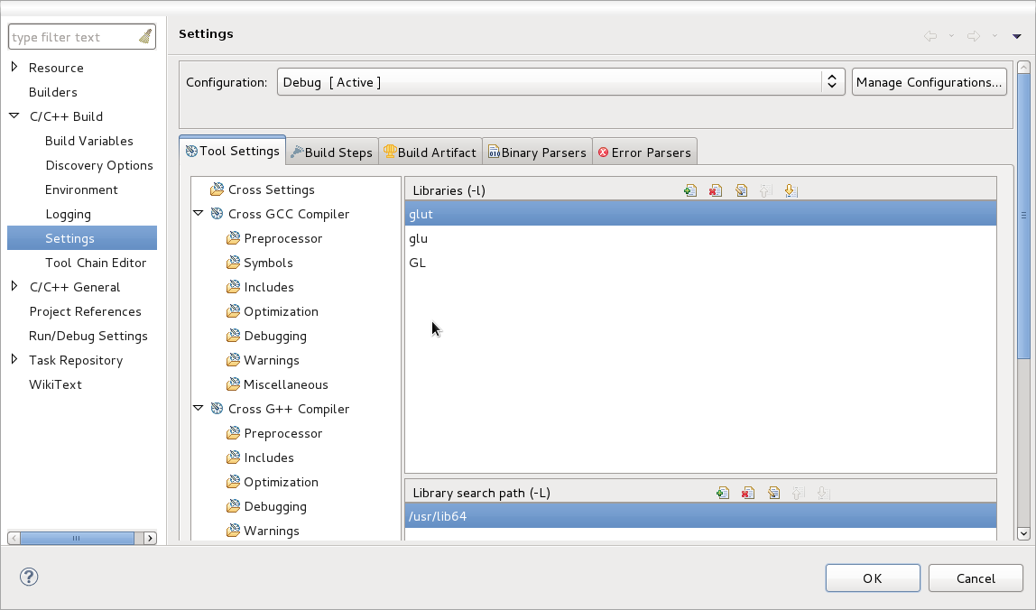

Re: Eclipse cannot find already included libraries ? (Desparate for help) [message #989290 is a reply to message #988620] Wed, 05 December 2012 09:47 Go to previous messageGo to next message
I have done that :
index.php/fa/12605/0/
Error now:
make all
g++ -L/usr/lib64 -o "hello_malaka"  ./hello.o   -lglut -lglu -lGL
/bin/ld: cannot find -lglu
Still getting error that I don't understand. It can't find glu but CAN find everything else. glu is there as well...

Re: Eclipse cannot find already included libraries ? (Desparate for help) [message #989295 is a reply to message #989290] Wed, 05 December 2012 09:53 Go to previous messageGo to next message
Are you sure that the library is glu. Should it be capitalized as GLU?
Re: Eclipse cannot find already included libraries ? (Desparate for help) [message #989298 is a reply to message #989290] Wed, 05 December 2012 09:58 Go to previous messageGo to next message
Ok I think i fixed it!
I had to include GLEW, GL and glut in -l (top window).
So I located them and added the path to the bottom window! Now It compiles!!!!
Thanks for your help everyone !
