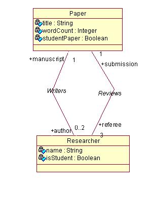

I use a model with two class diagram.
but I give a error that "not recognized variable referee" for
self.referee->forAll(r| not r.isStudent).
model is attached and a section of my code is:

Re: how to access to association end in code [message #988680 is a reply to message #988537] Sat, 01 December 2012 02:33 Go to previous messageGo to next message
If you understand you're problem well enough to present only a part of
it, you are surely able to solve the problem yourself.
I see no question in your report and no error message either, so it is
far from clear to me what you want to know.
I can only guess that you have neglected to realize that EMF reifies
model properties with getters and setters, so getXXXX.
If you want help ZIP up a simple project that demonstrates your best
endeavours at solving a clearly expressed problem.

thanks for fast your respond.
my project is attached.my first model was "paper-researcher-rose model.mdl"(rational rose model) that convert to .ecore and .genmodel model with eclipse and then
I build automatically code from .genmodel model but this code doesn't include association end's from uml model(.mdl).
how to built code from .genmodel model with association end's as attribute of classes.
error is:
org.eclipse.ocl.SemanticException: Unrecognized variable: (referee)
at org.eclipse.ocl.util.OCLUtil.checkForErrors(OCLUtil.java:358)

Re: how to access to association end in code [message #989120 is a reply to message #988738] Tue, 04 December 2012 12:08 Go to previous messageGo to next message
Hi Ed
I found a solution for own problem.the first converted new "paper-researcher-rose model.mdl" to .ecore
but still don't add association ends to clesses in .ecore model.
I manually edited .ecore model and added association ends attribute to classes and then create .genmodel.
in finally my project works without any error.
please more explain about "defines a class name with angle brackets in; surely a bad idea."
Best regards
