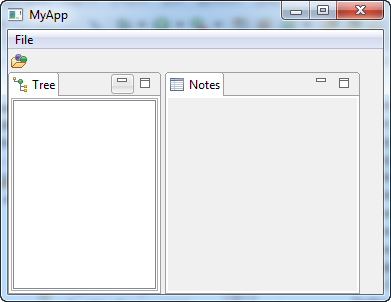

I need something similar to eclipse IDE, where a portion of the screen is empty when the application starts, and when I select s.t. in another part, an editor part opens in that empty portion representing the selection. Further, each selection opens in a new editor part in the same portion.
I have added an empty part stack, but it does not display and handle well. Is it the way it should be done ?
- the height of the tab bar is too small, and the min/max buttons overlap it.

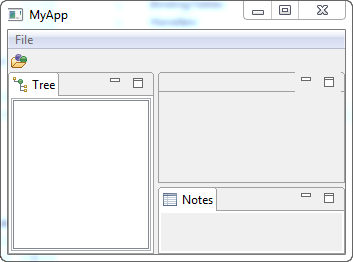

- when I minimize that empty stack, I get the following NPE, and the widget that usually contains the restore button is not rendered. Clicking on max seems OK though.

yes, it's a MPartStack.
Apart from the min/max and overlapping buttons, I programmatically add parts to that stack (like editors in eclipse ide), which works fine, but when I close all my editors, the region where the stack initially resides completely disappears (the other parts of the window fill in the empty space). When I open a new editor, it opens in its correct place (where the stack initially resides).
Is it a normal behaviour, or is it linked to the resolved bug you're talking about ? I want an eclipse-like behaviour, where the region containing editors never disappears when all editors are closed. Do I have to do s.t. special to get this ?
