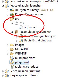

Re: Themes in RAP 2.0 M3 [message #988381 is a reply to message #988257] Thu, 29 November 2012 11:45 Go to previous messageGo to next message
Thanks Ivan,
Have been reading like crazy through all your links and related docs, but still cannot get my theme applied at runtime.
I'm running RWT as Standalone, and have added the Application Configuration as you suggested (note it is a different project to previous example, but same principle):

I think that the reference to the theme above is bogus, but not sure where and how this is supposed to be applied?
The project's plugin.xml now looks like this, although I'm guessing none of this is relevant as I'm launching through the web.xml using Application Configuration:

The CSS (css/aqua.css in this case) is very basic and looks like this (I just put some obviously bold colours in to see if it picked up the CSS at all):

Re: Themes in RAP 2.0 M3 [message #988388 is a reply to message #988381] Thu, 29 November 2012 12:23 Go to previous messageGo to next message
Hi John,
you have to change your RapierConfiguration#configure method:
public class RapierConfiguration implements ApplicationConfiguration {
public void configure(Application application) {
Map<String, String> properties = new HashMap<String, String>();
properties.put( WebClient.THEME_ID, "rapier" );
application.addEntryPoint( "/rapier", RapierEntryPoint.class,
properties );
application.addStyleSheet( "rapier", "css/aqua.css" );

Hold the press!
Got it working... the problem was the location of the CSS files... I assumed that the resources should be loaded relative to the project root, but in fact it was relative to the source root. Moving the CSS folder alongside my 'SRC' source folder was enough for it to start working (hopefully the image will display ok...):
index.php/fa/12580/0/
Job done... thanks Ivan for your responses on this too!
John
