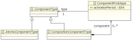

2) If you look at the ComponentPrototypeInstRef, the 'context' reference is in fact a list of references. This is because a ComponentPrototype can be deeply nested (in the ComponentType, look at the attached picture to understand the domain model). So there, I need to provide scoping for this reference but I need to know which element in the list of 'context' I have to provide scoping for, otherwise I'll end up in a cyclic resolution of lazy links.
I however have one requirement (which is pretty strict): I cannot change the domain model! The Xtext syntax is based on a domain model and not the opposite.
  • Attachment: EMFmodel.PNG
