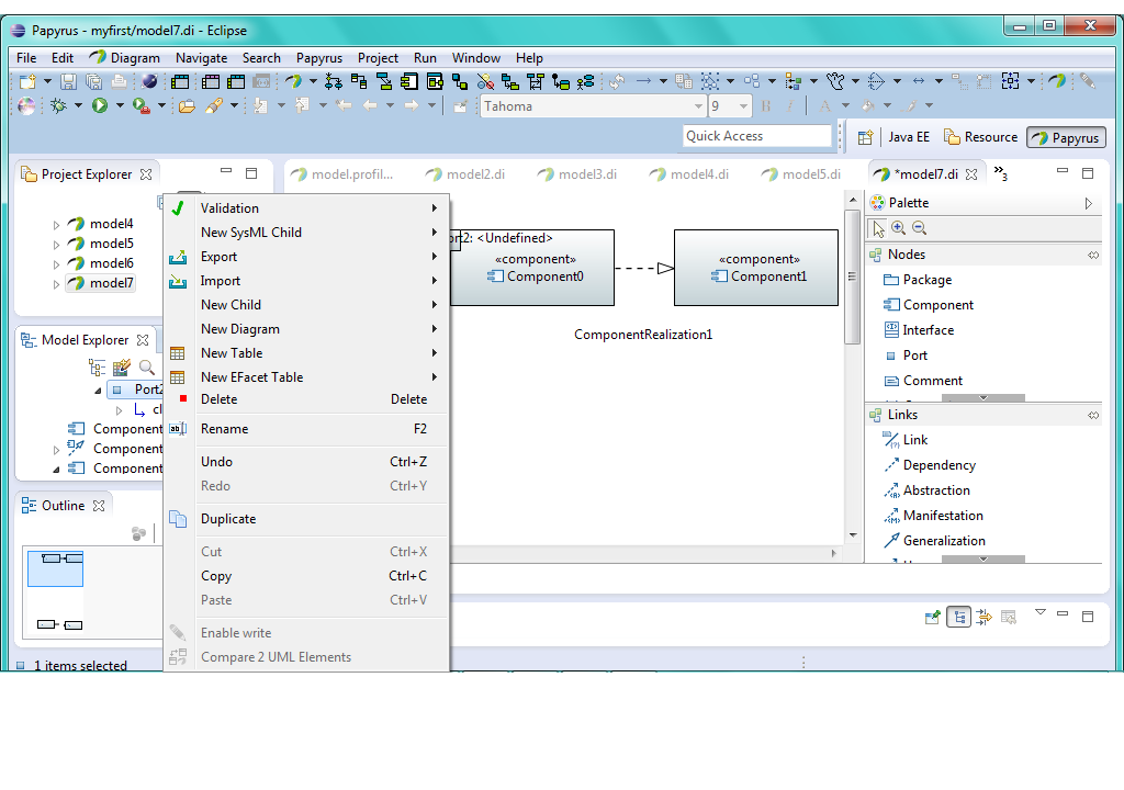

1*only use required and provided interface with component diagram?if yes
so in what case we use the interface element in Palette?
2*i try what you mentioned above
please check them to specify the correctness of them because when i right click on port i don't find "Manage Interfaces" option
Best Regards
Laya

Re: types of interface [message #987430 is a reply to message #987428] Mon, 26 November 2012 10:10 Go to previous messageGo to next message
The menu doesn't appear on the port's label (This is a usability issue).
You have to right click on the port element.
Camille

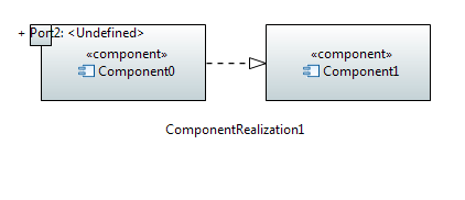

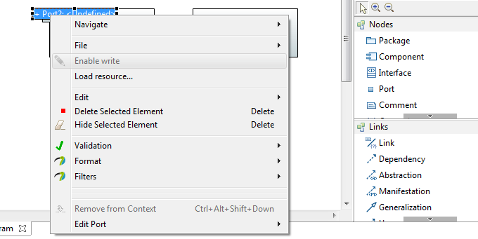

Re: types of interface [message #987433 is a reply to message #987430] Mon, 26 November 2012 10:24 Go to previous messageGo to next message
Hello Camille
Please check it
i didn't find this option
Laya

Re: types of interface [message #987702 is a reply to message #987699] Tue, 27 November 2012 11:31 Go to previous messageGo to next message
Hello Laya,
I've checked the handler test, and it's a little bit restrictive. The menu only appears when you right-click on a Graphical port (From the diagram). It won't be available in the ModelExplorer, nor on the port's label from the diagram.
Camille

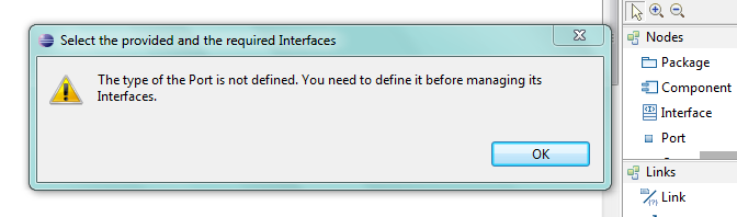

yes i find it but a message occur told me to define port before manage it as illustrated in attachment
how can i define it?
Laya

Re: types of interface [message #988805 is a reply to message #988616] Mon, 03 December 2012 04:58 Go to previous message
Hello Laya,
To manage ports required/provided interfaces, here are the steps to follow:
- Create a Port on either a Component (Component diagram) or a Class (Composite structure diagram)
- Set this Port's type to either a Class or an Interface
- Right click on the graphical representation of the Port, and select "Manage interfaces"
- Select the interfaces this Port provides (i.e. implements) and requires (i.e. depends on). Note that when the Port is typed with an Interface, this interface is automatically "Provided", and you cannot add new Provided interfaces.
So, two things to remember:
- Provided/Required are derived properties. They are derived from the type of the Port. So the Port needs a type before you can use "Manage interfaces"
- The "Manage interfaces" menu is only available on diagrams, for Composite Structure and Component diagrams. You have to right click on the graphical representation of the Port. This is a tool limitation which will need to be fixed.
Camille
