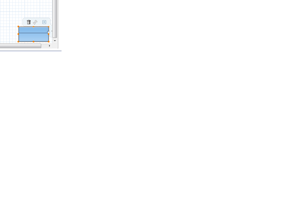

Hello All,
Context pad will appear for a shape based on Context Pad Location.the rectangle what ever passed to ContextPad.
ILocation origin = getAbsoluteLocation(ga);
contextButtonPadData.getPadLocation().setRectangle(origin.getX(), origin.getY(),
ga.getWidth(), ga.getHeight());
Contextpad will appear at Top && Right of the rectangle.
Contextpad will not appear fully if shape is at the corner of Horizantal and Vertical scrollbars as shown in attachment.
Is there any possiblity if Contextpad is not in viewport area, can I change contextpad location to Top && Left of the shape,
Advance thanks for your reply.
Raghav

Raghav,
this cannot be changed as of today. What you may try is to adapt the
location of the context pad from within yout tool behavior provider in such
a case.
Michael
