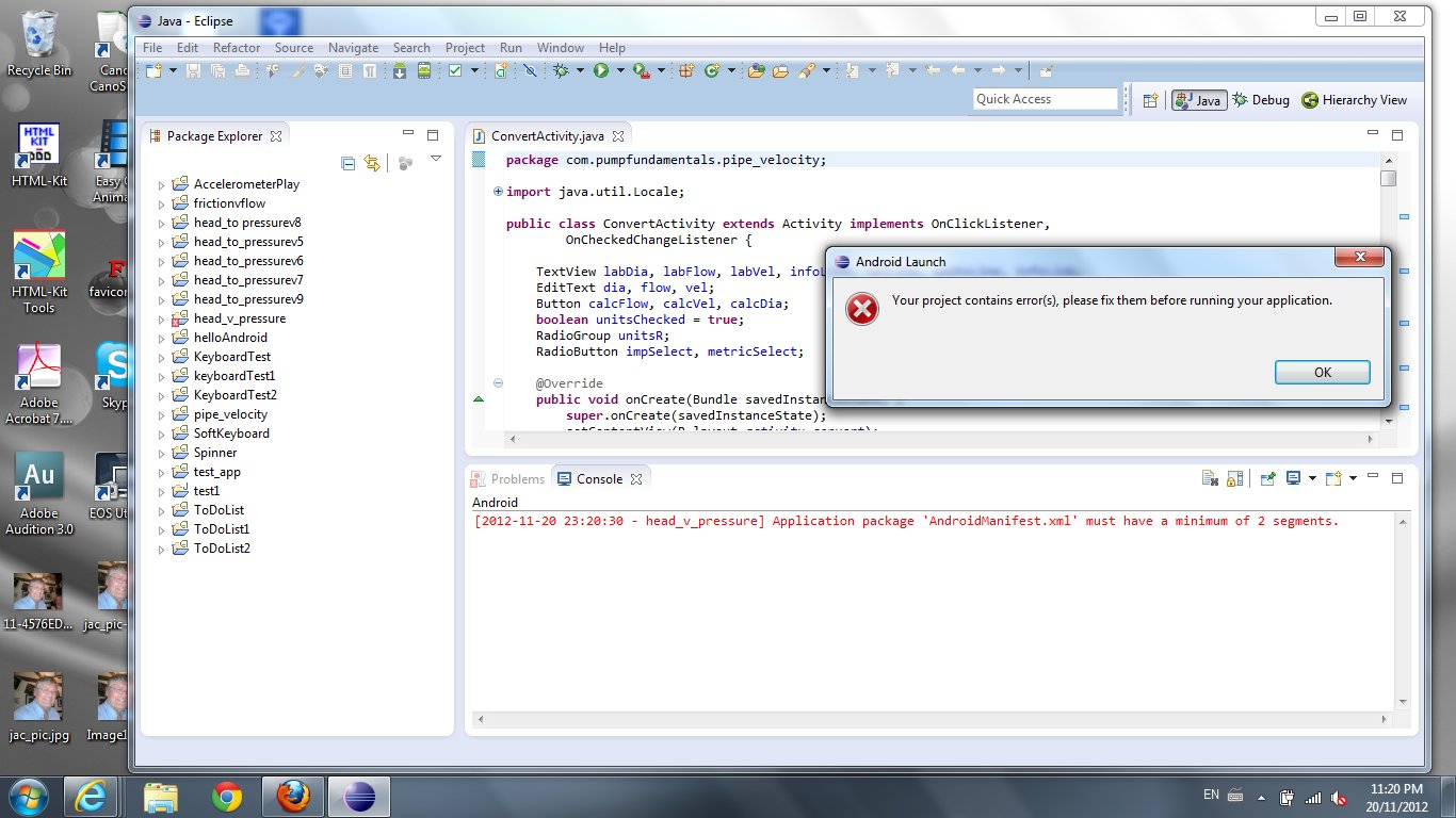

Re: eclipse will not compile [message #986591 is a reply to message #986572] Wed, 21 November 2012 01:23 Go to previous messageGo to next message
OK, that's a start, here's a screenshot of what happens. I could send the code if someone wanted to look at it, but not sure how I would send it since it is distributed over many folders.
Thanks.
Jacques

Okay. At the risk of offending anyone here (since this isn't an Android
forum), please send the source to your manifest (AndroidManifest.xml).
We'll take this one additional step before moving your post to
stackoverflow.com. This is what the error appears to refer to.

I'm not certain since this never happened to me. (Also, I don't know
what the ????? is standing in for here.)
Googling for androidmanifest.xml segments, I see notes to the effect
that the "package="xxx.yyy" attribute should be a package name
consisting of at least two levels of hierarchy (i.e., "two segments"),
such as fr.chaurette (and not merely pump_power?). However, I think this
is a bit of a red herring (une fausse diversion, quoi).

In conclusion, I'm not so sure there has to be two levels of hierarchy,
the error would seem to say so (my projects all have full corporate
hierarchy anyway), but whatever the case, surely the Java file
containing the ListActivity class extension must be in the package noted
in AndroidManifest.xml.

Re: eclipse will not compile [message #987657 is a reply to message #987550] Tue, 27 November 2012 08:18 Go to previous messageGo to next message
I put in the "?" only because the forum rules do not allow url's but maybe it was only the 1st one that was a problem, I am trying again.
Yeah, I think the 2 segment error is a typical error the compiler throws out when it doesn't have anything better to say.
Jacques
