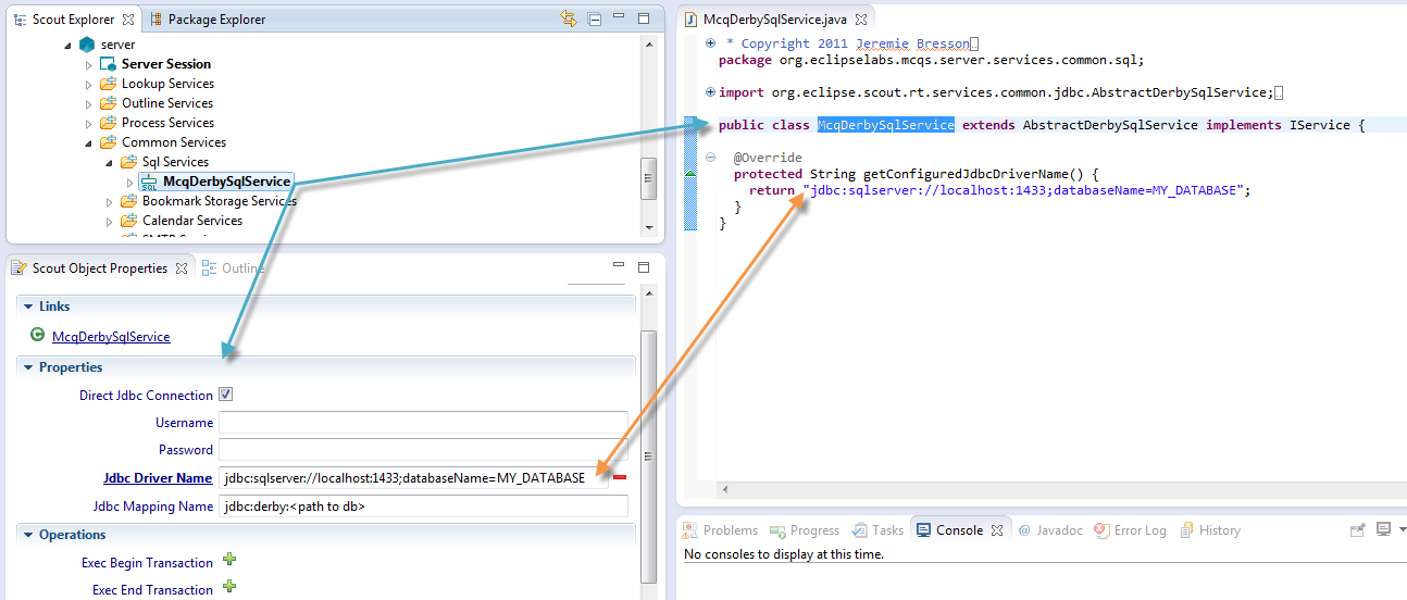

You are experiencing difficulties in the Scout SDK. Can you indicate the version of your Eclipse and the platform? If you could also add a screenshot... This will allow us to try to reproduce your bug.
I do not know the property you want to set, but if the properties view is not working, you can set it in the code:
For example:
protected String getConfiguredJdbcMappingName() {
  return "jdbc:sqlserver://localhost:1433;databaseName=MY_DATABASE";
Correspond to the property: "Jdbc Driver Name"
Here as picture:
index.php/fa/12329/0/
It is an example with a Derby database, because I do not have MySQL installed in this project. Properties view and java code are synchronised the same way everywhere.
In Scout the Java code wins over the SDK tools. There is no temp file for the content of the property view or stuff like that.

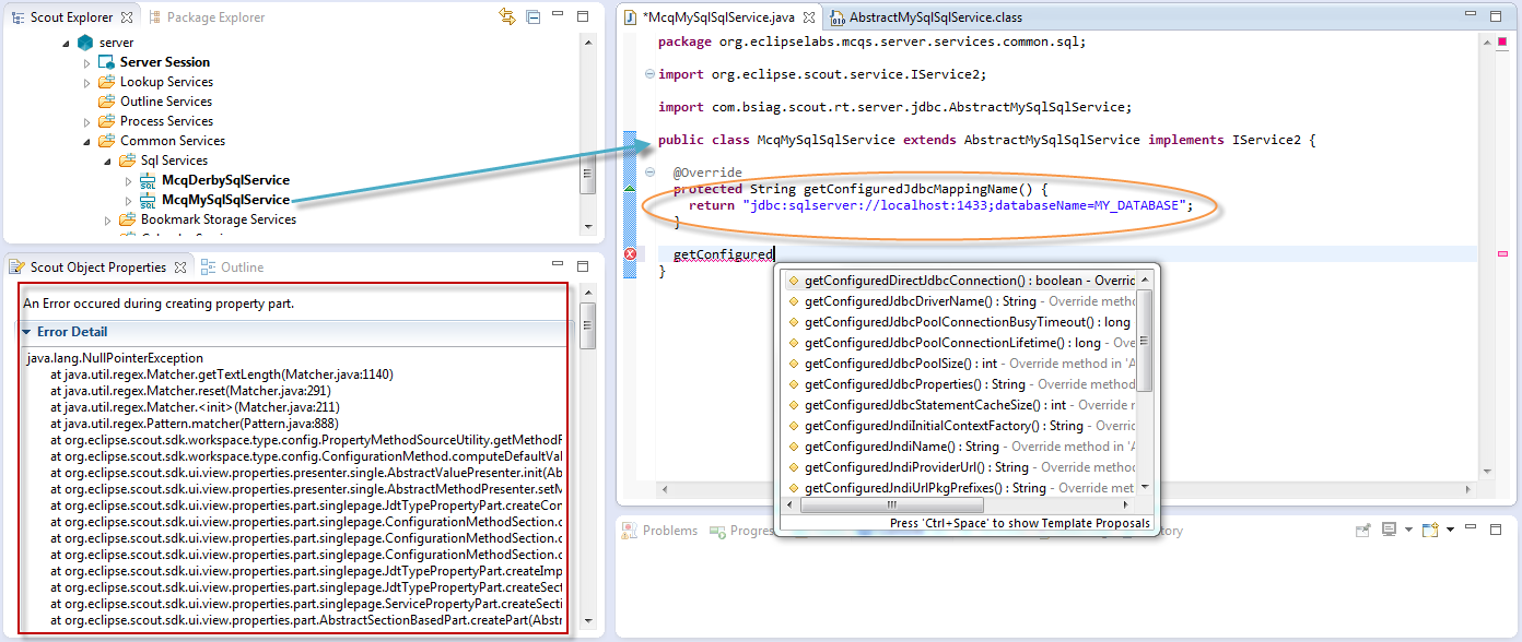

I could reproduce your bug:
Eclipse for Scout Developers
Version: Juno Service Release 1
Build id: 20120920-0800
Platform: win32
Code of DefaultMySqlSqlService:
import com.bsiag.scout.rt.server.jdbc.AbstractMySqlSqlService;
import org.eclipse.scout.service.IService2;
public class DefaultMySqlSqlService extends AbstractMySqlSqlService implements IService2{
See attached screenshot.
Could you file a bug?

From what I have analysed from the stacktrace:
The problem occurs when the SDK try to compute the default value:
at org.eclipse.scout.sdk.workspace.type.config.PropertyMethodSourceUtility.getMethodReturnValue(PropertyMethodSourceUtility.java:86)
at org.eclipse.scout.sdk.workspace.type.config.ConfigurationMethod.computeDefaultValue(ConfigurationMethod.java:88)
I think the problem is that I have no source for the com.bsiag.scout.rt.server.jdbc plugin...
I see two fix:
1) I see no reason why the source code is not provided for com.bsiag.scout.rt.server.jdbc
2) Fix the SDK: the properties view should not crash if something is null at:
org.eclipse.scout.sdk.workspace.type.config.PropertyMethodSourceUtility.getMethodReturnValue(PropertyMethodSourceUtility.java:86).
=> Should the fix in Bug 394374

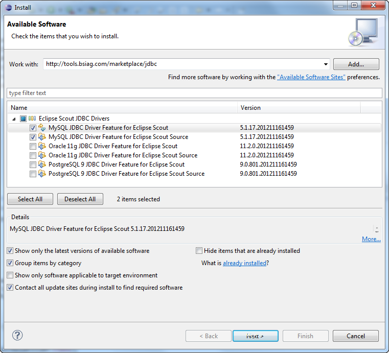

Re: Null Pointer Exception when accessing the properties of AbstractMySqlSqlService [message #985895 is a reply to message #985859] Fri, 16 November 2012 10:30 Go to previous messageGo to next message
For Juno I suggest to create a new JDBC feature build including the sources. This has the following advantages:
1. the fix can be provided out of the release cylcle of Eclipse and will therefore be availablel before SR2
2. the sources of these features should be provided anyway (independent of this bug). I see no reason why the sources should be kept closed.
3. there is no risk to introduce a new/changed behaviour or other problem for Juno SR2
what are your opinions?
Since providing the source bundles and features for the JDBC drivers for Eclipse Scout do solve the problem, I recommend that the patch should be applied for the Kepler release only and not for Juno if you think that we could risk changing the behavior.
I provided a new build of the JDBC driver at the Eclipse Marketplace that includes the source features and bundles.
To update to the latest build, click on the menu [Help]->[Check for Update] or [Help]->[Install New Software...] and add the URL http://tools.bsiag.com/marketplace/jdbc

Ken Lee wrote on Fri, 16 November 2012 16:30
I installed the new version (see screenshot) and it works now with Juno-SR1. Thanks a lot.
-> That is my first point in #msg_985681
