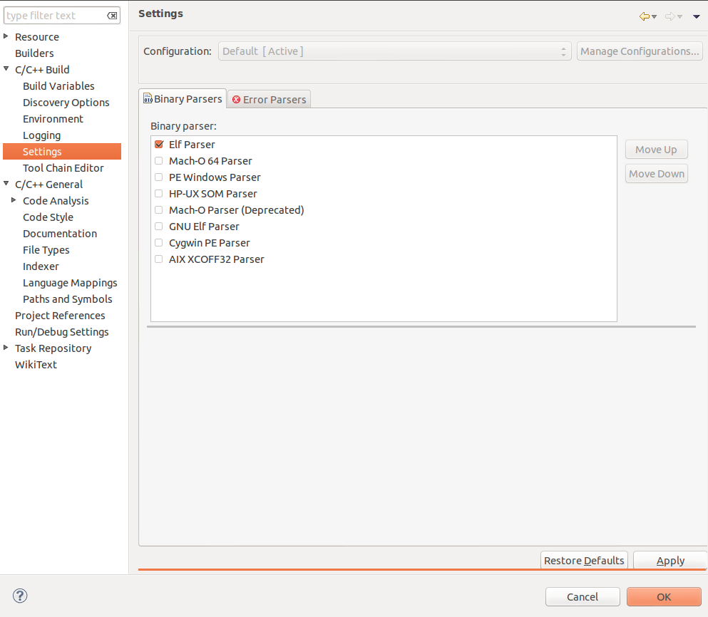

I want to add an *.so file to my project so that it dont shows all the functions while auto completing and to remove errors.
I followed the below procedure
project properties->C/C++ build->Settings->GCC C++ Linker->Libraries->
but there ins no way to open GCC C++ Linker. I have attached a screenshot of the same. Please check it
index.php/fa/12318/0/
Any help is appreciated Laughing

You are using a so called Makefile project, i.e. you provide a Makefile and Eclipse will then just call make. Eclipse will not change your Makefile or offer you the GUI to modify it. You have to add the linker options in the Makefile manually.
If you want Eclipse to manage the Makefile then you must go to project properties->C/C++ build and check "Generate Makefiles".
