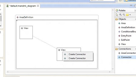

I wanna draw an AreaDefinition and inside it I would to draw a Connector (gmf.link) between two Views (gmf.node), but the editor show to me two different choices (instead of only one) of the Create Connector context menu.

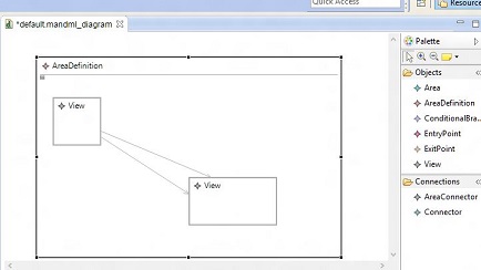

1) If I click on the first one the editor draws two Connectors as shown here
index.php/fa/12313/0/

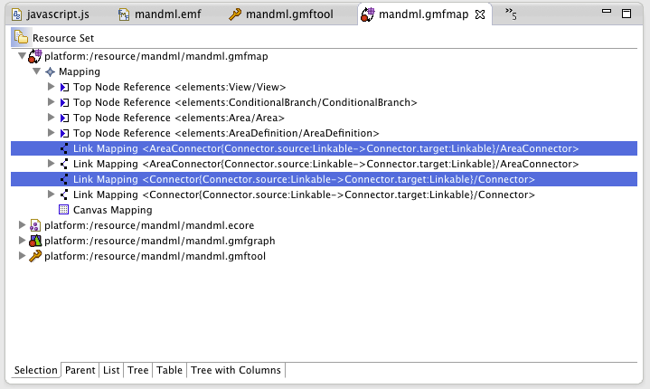

Eugenia seems to be generating two extraneous LinkMappings in the .gmfgraph model (see screenshot) which appear to be causing the problem. Deleting them and regenerating the .gmfgen model and then regenerating the diagram code (you'll need to delete your .diagram project first) seems to be fixing the problem. Instead of deleting these manually every time, you can write a small script that does this automatically every time you run Eugenia (see [1]).

Modifing the .gmfmap manually as you suggested, the editor don't show anymore the double choices in a context menu, perhaps the editor draws two links between the nodes anyway. After some attemps I noticed that selecting a new "create tool" (from the right side of the editor) one of the two links disappears. What a strange behaviour! Do you have the same?
