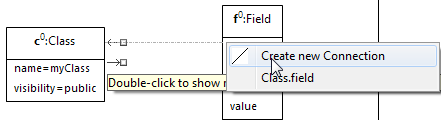

Hi all,
I try to select an entry from the context menu that gmf displays after creating a connection between two model elements. However I do not get matched any widget as long as I have the context menu displayed.
index.php/fa/12305/0/
For testing I have the follwing statement running without any problem (3 items are matched) as long as the context menu does not show up.
List<Tree> items = bot.getFinder().findControls(WidgetMatcherFactory.widgetOfType(Tree.class));
Now whenever context menu shows up this statement does not match any single widget. I tried this with TabbedPropertiesList, MenuEntry etc. I always have the same result.
Any idea?
Ralph
  • Attachment: menu.png
    (Size: 7.39KB, Downloaded 923 times)

Hi Mickael,
Thanks for your quick response! The bug is not after the context menu is displayed it is while displaying. I assume that while the context menu is displayed I would find the menu entries with something thing like this statement:
List<MenuEntry> items = bot.getFinder().findControls(WidgetMatcherFactory.widgetOfType(MenuEntry.class));
This statment did not return any result. Hence, I tried to do it with statements of which I was sure that there should be an result(the Tree example mentioned above). These examples did not return a result while the context menu was open too.
My problem is that I cannot click on such a context menu button because SWTBot finder does not seem to find any widget while this dialog is open. Is there a way to locate the bug a bit closer when I want to open a bug report?
Ralph

Hi Mickael,
what you see in the screenshot is a GMF PopupMenu (http://dev.eclipse.org/viewcvs/viewvc.cgi/org.eclipse.gmp/org.eclipse.gmf.runtime/plugins/org.eclipse.gmf.runtime.diagram.ui/src/org/eclipse/gmf/runtime/diagram/ui/menus/PopupMenu.java?view=markup&revision=1.3&root=Modeling_Project) which uses SWT Menus. Hence, I would assume that
editor.bot().menu("Class.field");
would work. This does not find any widget.
With "locate bug closer" I asked for a hint on where to look for what is going wrong.
Ralph

Hi Mickael,
this does not work either. I think the problem is that this menu is not coming from a right click but from the GMF Graphical Node Edit Policy while creating a link. I use the follwing commands to get until the menu is displayed:
Point targetPoint = target.getFigure().getBounds().getCenter();
target.getFigure().translateToAbsolute(targetPoint);
editor.activateTool("Role");
editor.drag(sourceLabel, targetPoint.x(), targetPoint.y());
editor.bot().sleep(1000);
//Try here to click on the presse menu
I printed out all menus that are available via
	editor.bot().menu(editor.bot().activeShell(), new BaseMatcher<MenuItem>() {
			public boolean matches(Object item) {
				System.out.println(item.toString());
				return true;
			public void describeTo(Description description) {
				// TODO Auto-generated method stub
		}, 0);
but this displays all menus except the menu items displayed after creating the connction. Is it possible that these are displayed on a different shell or thread to which SWTBot does not have access?
Ralph
